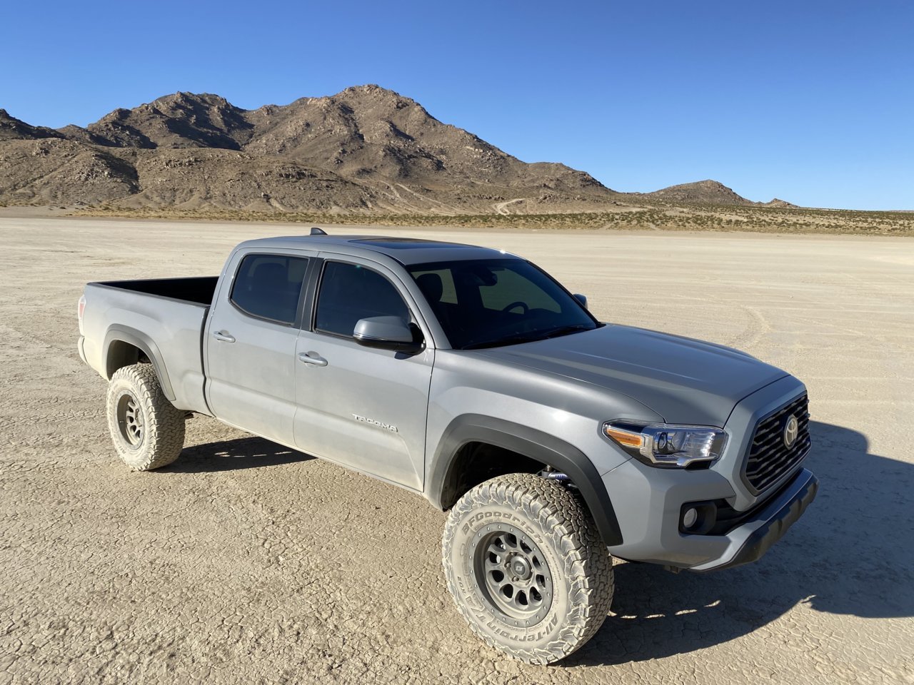

    I've got the Fox 2.5's with DSC and ICON pack in the default config. Not option 2 or 3. Out of the box the shocks were too stiff, front and rear. Meaning, I had the adjusters all the way soft on high and low speed compression and was getting beat up on the freeways. I gave them to Acutune to soften them up a bit. Now they feel pretty amazing on the highway. When I go off road (desert) I'm dialing in 2-3 clicks in the rear and one click in the front on high speed compression. Feels amazing. Depends on how fast you want to go.

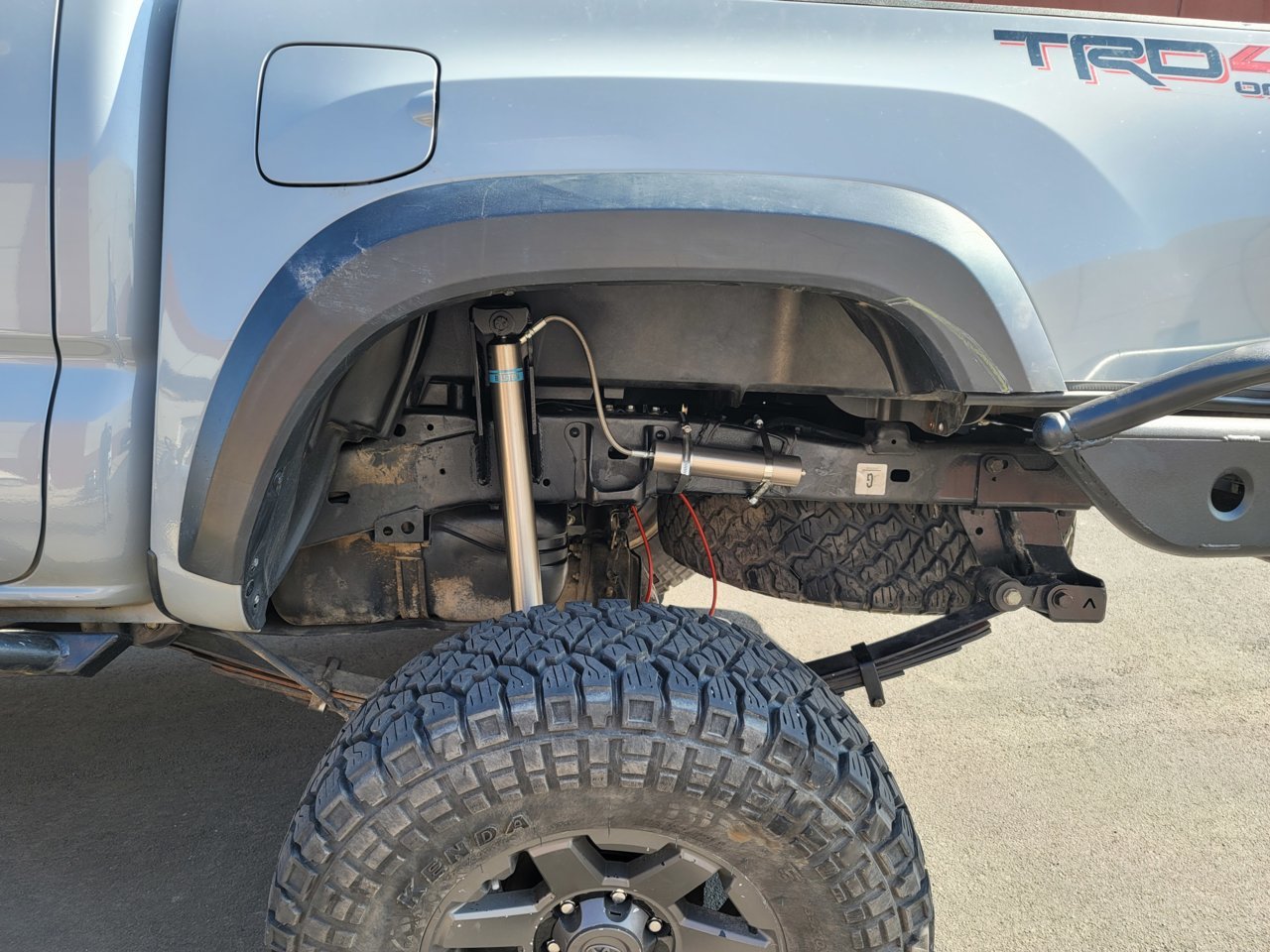

    I like flex
