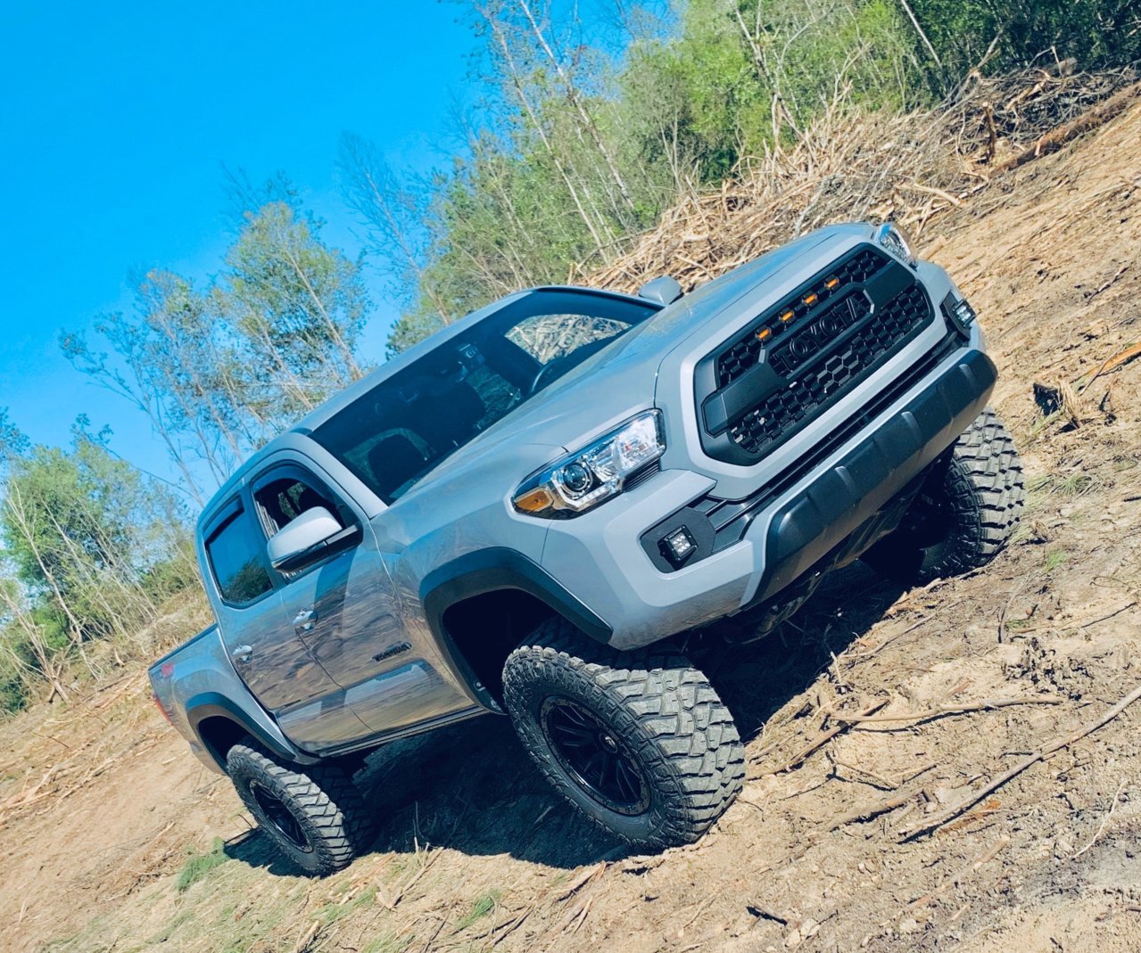

    Okay, I had this kit installed - 3"F / 2"R SST LIFT KIT BILSTEIN 6112 COIL-OVER - TOYOTA TACOMA TRD / SR5 / ROCK WARRIOR 2005-2020
    I added 5100’s to the rear. Highway driving and the lite off-reading/overlanding, it is great. But.......... Yesterday, I had 20 bags of mulch loaded and the truck was ass sagging. So, yes, I have blocks, rookie mistake.
    My question is, I am getting installing a SOS rear bumper with tire carrier, gas carrier - so I am thinking of adding rear springs. I cannot find how much lift the Icon RXT lifts the rear. Also, some guys on here use blocks with AAL, do I install the Icon RXT with the blocks?

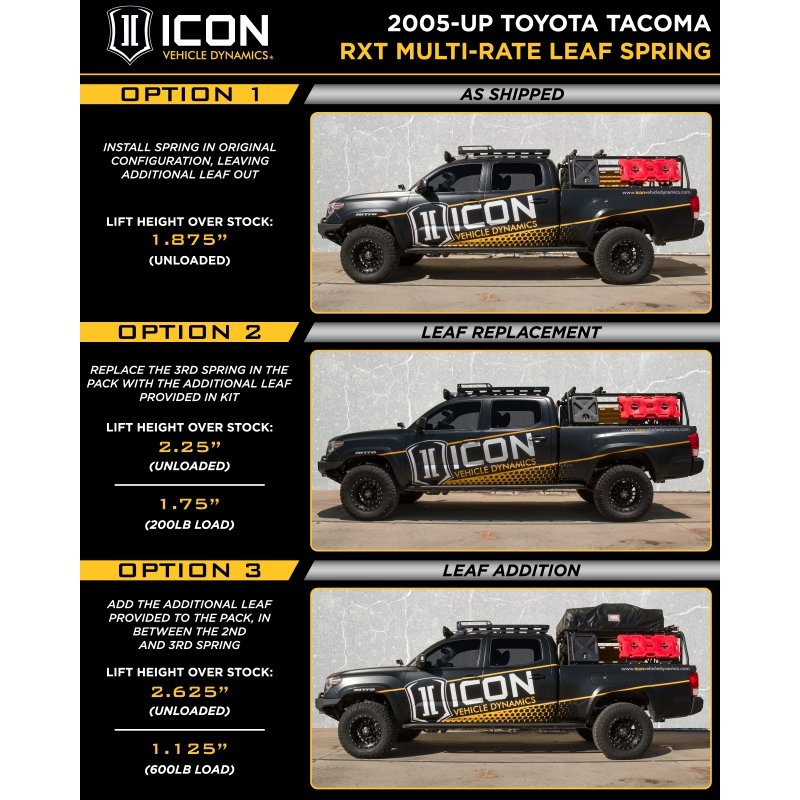

    Don’t add blocks to the RXT Leaf pack. If you haven’t already, take a look at the 3 options for the leaf pack:

    Those are nice......Can I use my 5100’s with option 3?

    yes on your shocks, but I would bet you'll want to run option 2

    You probably aren’t gonna want option 3 unless you have more weight on the bed
    I’ve got a set on my tundra running option 2 with +400 lbs over factory.

    Thanks, I will go with option 2.
