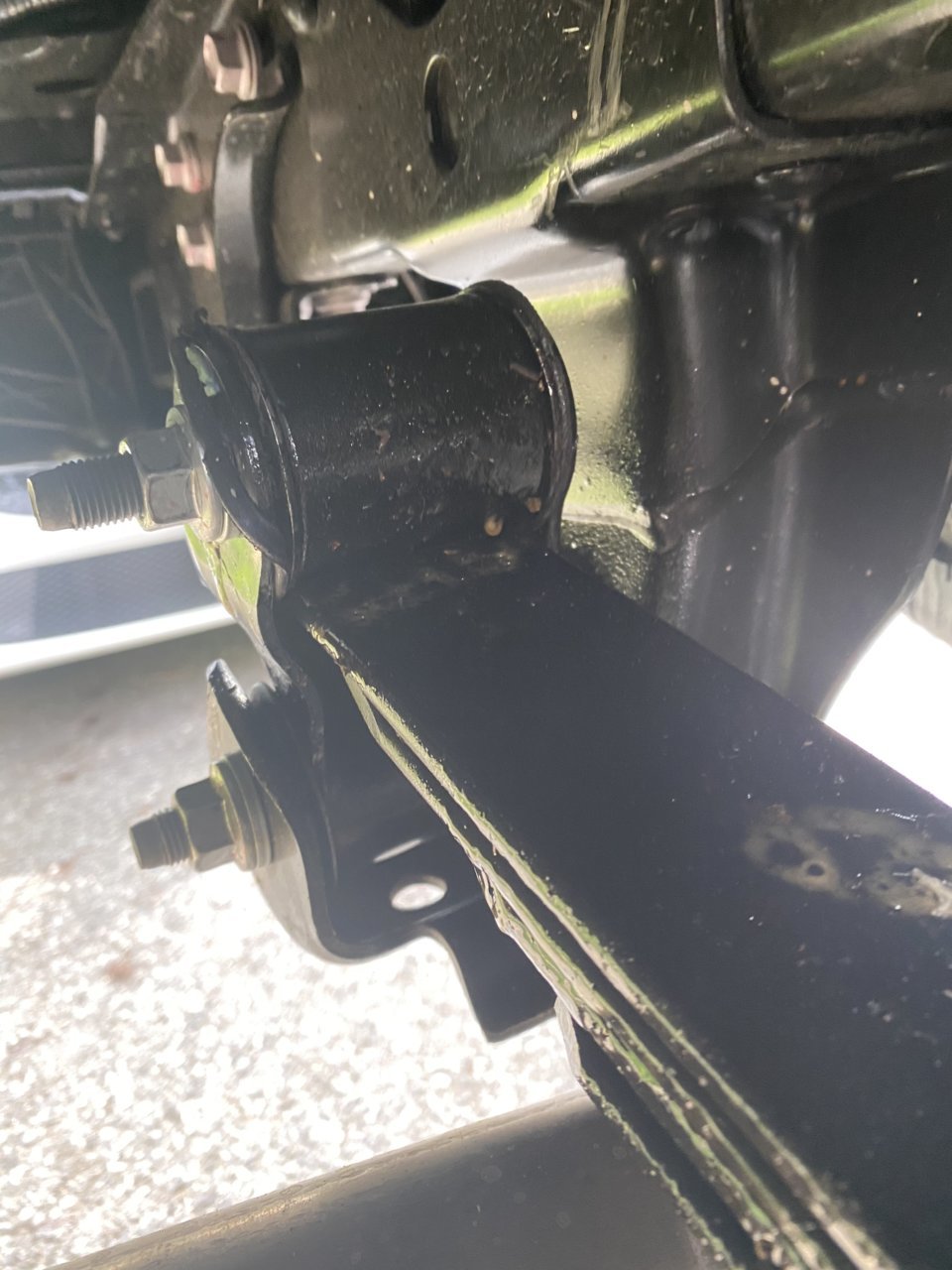

    Hi
    I have a bad squeak coming from my rear leafs set at option 3. I was looking around and saw this. I’ve used fluid film between leafs and everything and nothing helps

    Is that part of the bushing coming out? Did you torque it properly?
    I torqued everything when I lowered the truck off the lift. No problem with mine, maybe you over torqued it?

    I’ve used the torque spec of 89

    But did you set it down first before torque? I made the mistake of torquing the front UCA bolt the first time I did it while it was still jacked up and it binded (what looks like yours are doing). Had to replace my bushing cause it tore it up.

    First time I installed I think I did torque before. 2nd time around i torqued after

    I am a bit confused; so this is the second time you installed it and you torqued it after setting it to the ground and on its own weight correct?
    On that topic, I do think you need a new bushing. It looks pretty torn to me and that may be the source of the squeaks.

    Yes I had them on my previous taco removed them and installed on this one.

    I think that bushing is bad. May fix your squeaks after replacing it.
    Edit: contact Icon, they may have a kit to just replace the bushing.

    It seems to be on both sides and the bushings are in a good shape there

    Would misaligned leaves have something to do? Like they are not properly lined up
