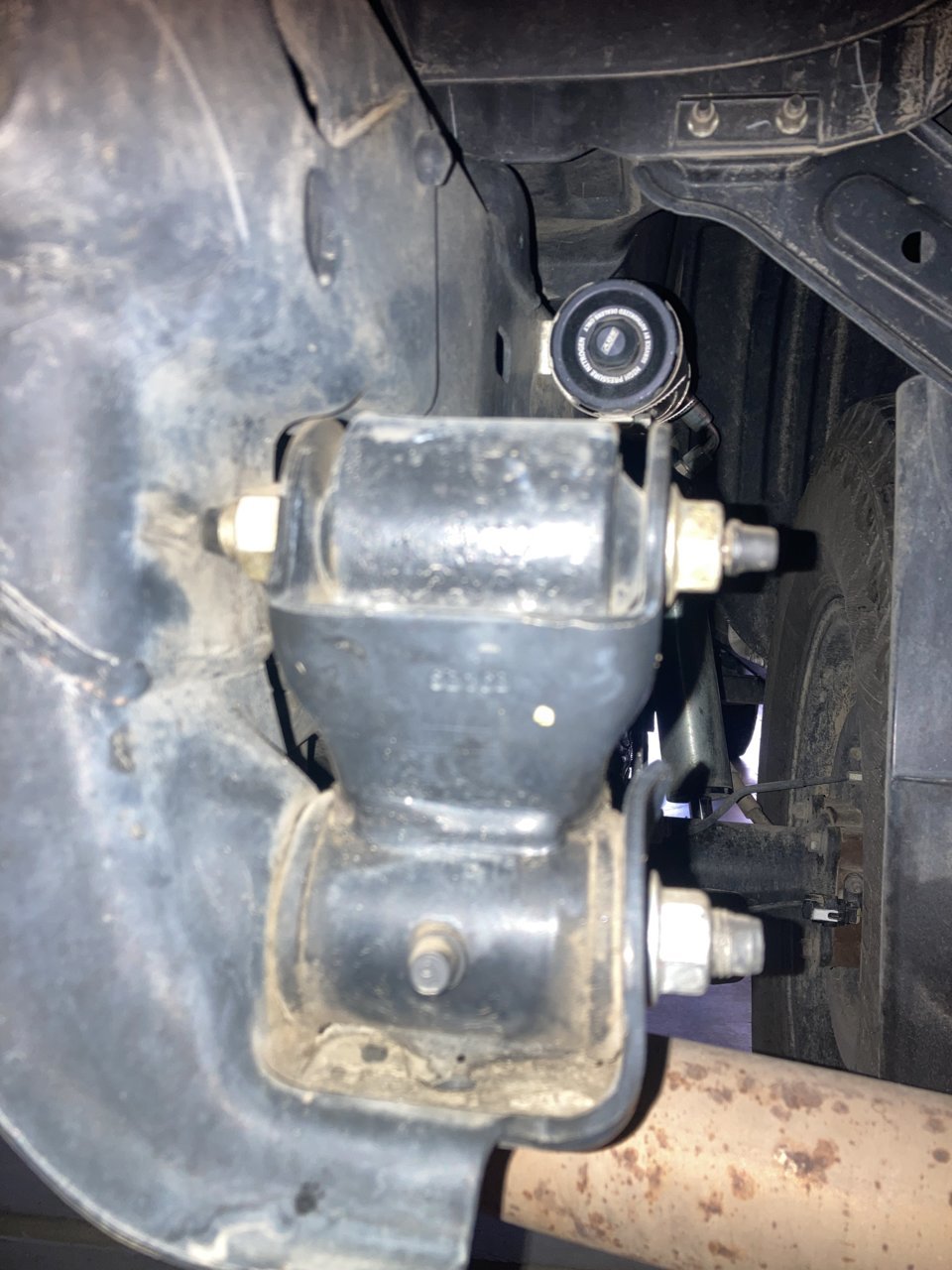

    Exchange out those stock bolts with the Dobinson greasable (zerc) bolts and if you are inclined…take the shackle off, drill a hole in the back where it rounds and put a self-tapping grease zerc in the hole. Been running this for years with zero squeaks even with lots of desert runs with all the dust.
    Notice rubber covers on zerc nips on shackle and bolt
