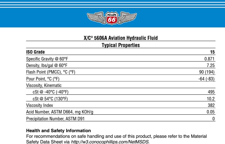

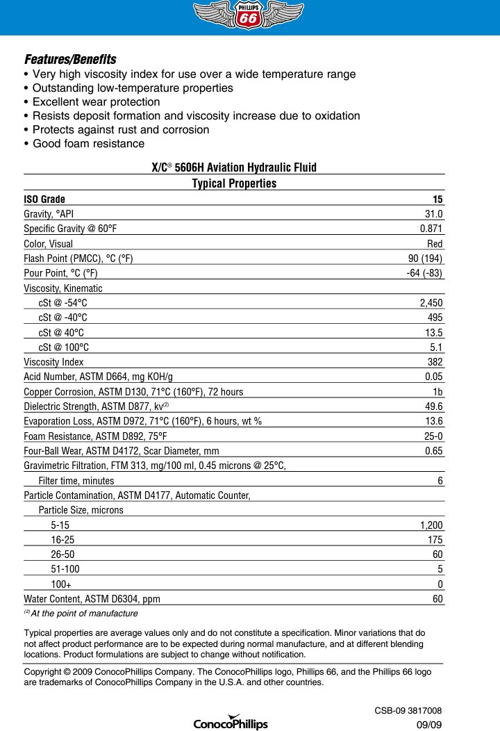

    Here is the info on this fluid:
    Phillips 66® X/C 5606H Aviation Hydraulic Fluid is a mineral oil-based fluid with a high viscosity index. It is ashless (zinc-free) and helps reduce wear for longer lasting components and reduced maintenance costs. The fluid is designed to meet the severe demands of aerospace and industrial applications. It is available in several container sizes and is priced low. This hydraulic fluid boasts excellent oxidation resistance and outstanding low temperature properties, making it ideal for long-haul flights and for use over a wide temperature range. Use the fluid in hydraulic pumps and motors to protect sensitive hydraulic system components against rust and corrosion. The premium hydraulic fluid is also resistant to excessive foam buildup that can cause poor or sluggish hydraulic system response.
    Phillips 66® X/C 5606H Aviation Hydraulic Fluid meets the cleanliness requirements for "super clean" hydraulic fluid for use in modern aircraft hydraulic systems. This fluid is dyed a vibrant red color for identification and easy leak detection purposes. Phillips 66® X/C Aviation Hydraulic Fluids are recommended for use in non-pressurized systems operating between -54°C and 90°C (-65°F to 194°F), and in pressurized systems operating between -54°C and 135°C (-65°F to 275°F) at pressures up to 3,000 psi. It is available in your choice of container size and a manufacturer's certification may be added to any order for an additional charge. Order your Phillips 66® X/C MIL-PRF-5606 Aviation Hydraulic Fluid today to treat your system right.

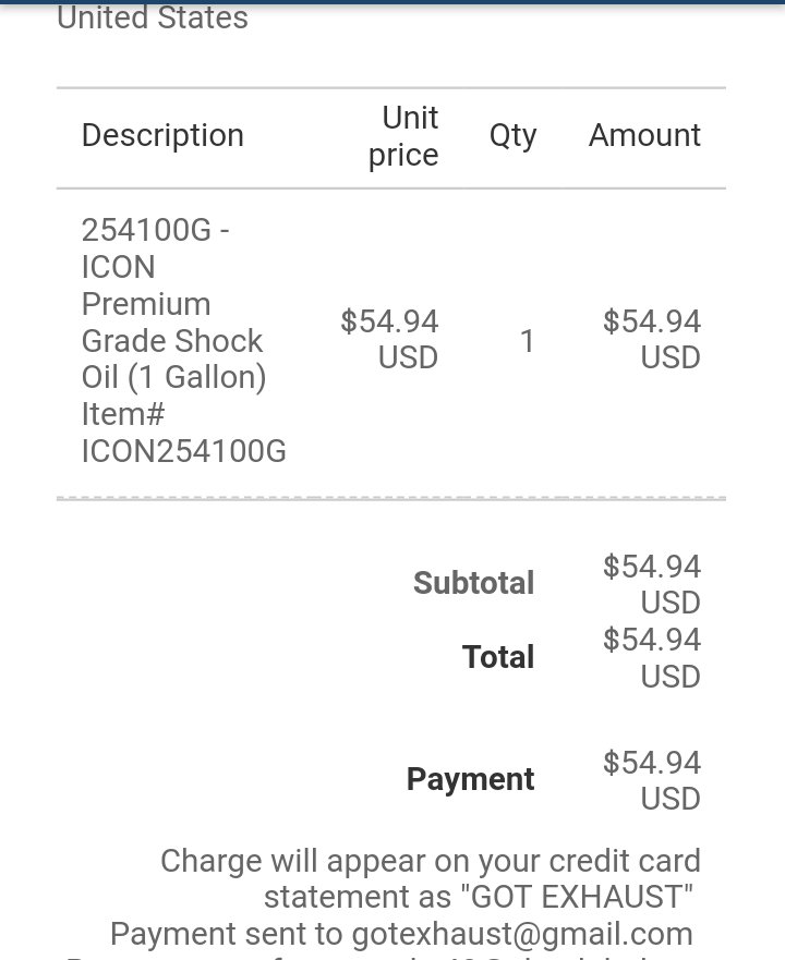

    Thanks for that info. I did see these fluid weights after doing a little research.
    I ended up going with Icon fluid only because I found it on Gotexhaust.com for $54.94 TOTAL
    1 gallon jug
