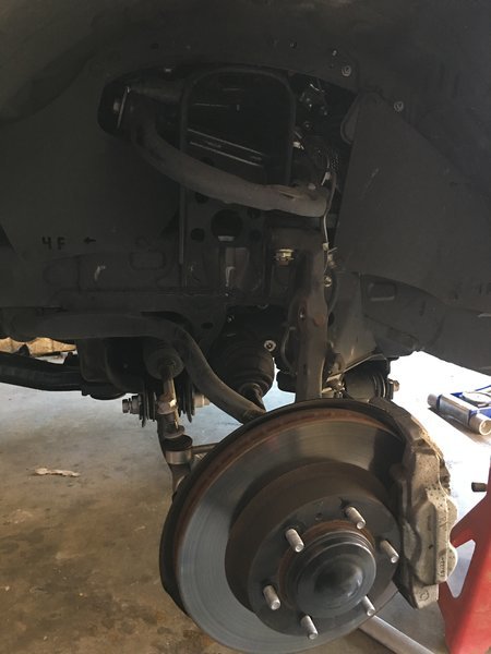

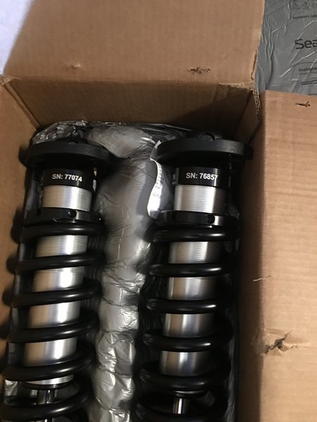

    Im currently installing my icon stage 2. I got the front shocks removed and im about to install icon shocks. I see that each shock had a different SN. One has SN: 77074 and the other has SN: 76857. Are the different numbers for different sides?

    No serial number for anything should match.
    Part number wise, should be the same

    No. Just put them in
    Serial numbers are not the same as part numbers.
    Serial numbers are different for individual parts.

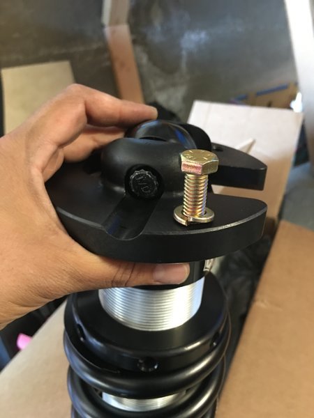

    IMG_8393.jpg Did you guys use any of this hardware? I just used the old nut for the
    Shock tower

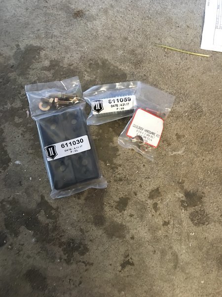

    The blocks are for the sway bar relocate
  10. Jun 18, 2017 at 6:07 PM

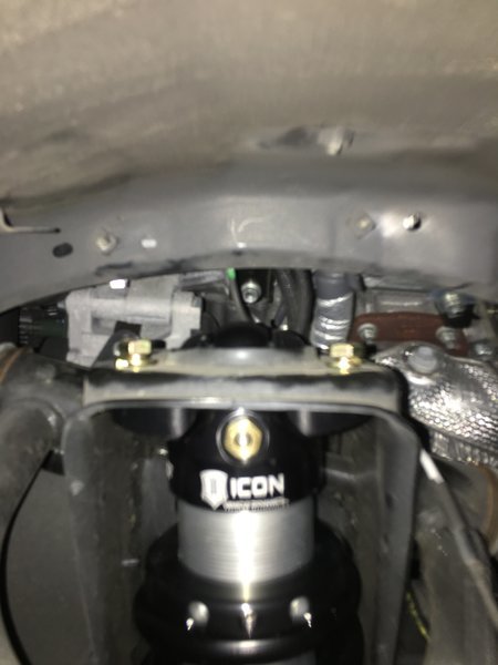

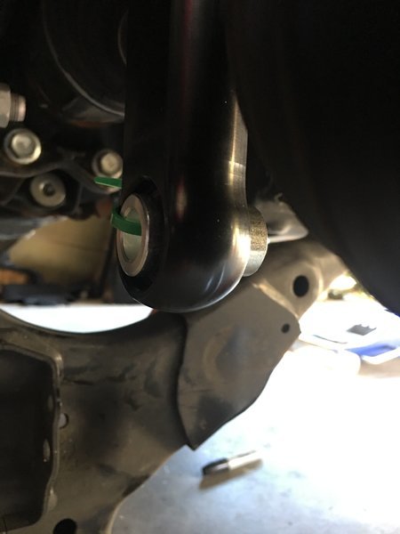

    If it's anything like the shocks for 2nd gens, the spacers on the bottom bearing are not the same. Make sure the longer spacer is in the front. The shocks themselves are the same left and right.

    Sorry for all these dumb questions. Does the lock washer sit inbetweem the the shock mount and shock tower or does it just sit on top of the shock tower?IMG_8394.jpg

    They go on top of the shock tower.

    Not talking about the rear shocks. The aluminum spacers for the bottom bearing - make sure the thicker spacer points toward the front. It's for sway bar clearance.

    IMG_8395.jpg Like this right?

    Yes

  17. Jun 18, 2017 at 6:21 PM
    #17
    Marvelousone
    Marvelousone [OP] Well-Known Member
    Nov 30, 2016
    #203730
    183
    San Francisco CA
    2017 DCSB Sport
    IMG_8396.jpg Its pointing towards the rear right now. Guess i got it wrong. Good thing you said
    Something before
    I torqued it all down. Youre awesome man thanks!
    SilverII and KingTaco81 like this.

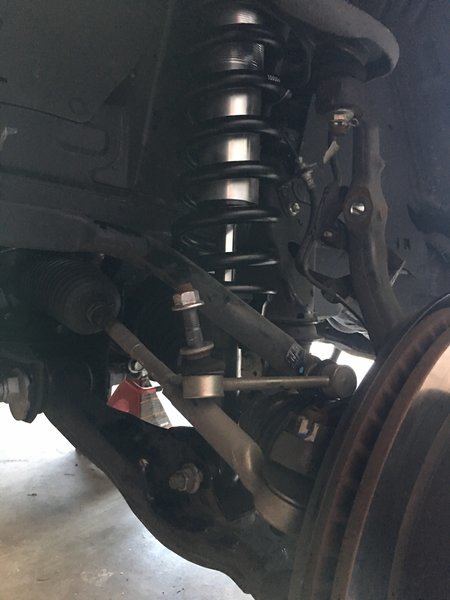

    IMG_8397.jpg One side is in. You guys think thread lock is needed for the bolts for the lower shock mount?

    Maybe it's just the angle of the pic...looks like the top hats differ in thickness.

    It might..but just as someone said and also in the direction the spacer on the bottom shock mount is suppose to face forward and the plug for the hose is suppose to face outward making it side specific
