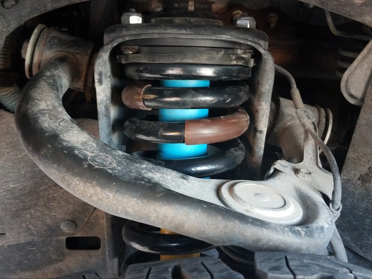

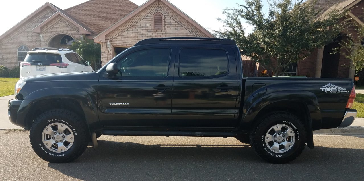

    The factory components of a 3rd gen TRD Off Road will lift a 2nd gen by 1". I'm using stock suspension from a 3rd Gen with a 1" lift spacer. So that's 1" from the 3rd gen coilover, and 1" from the spacer making that 2" of total front lift.

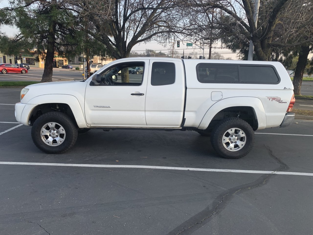

    I just had a icon stage 1 lift installed. New UCA’s icon tubular delta’s and new leaf kit 2.5coil overs and 2.0 rear shocks. 9A04611B-819D-4FBE-981E-B727D29997DC.jpg Had it on for 5 days and love it. Just took it up to the snow and it did awesome.
