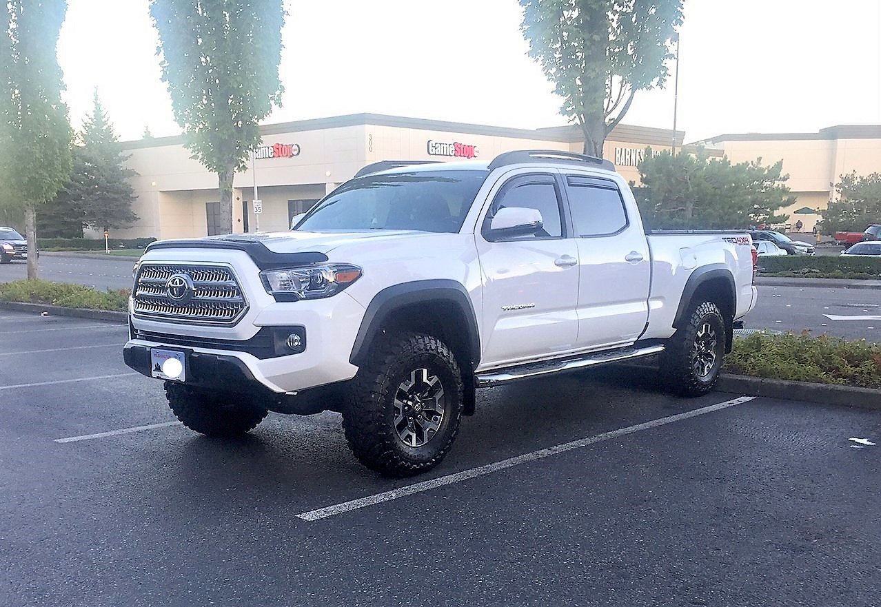

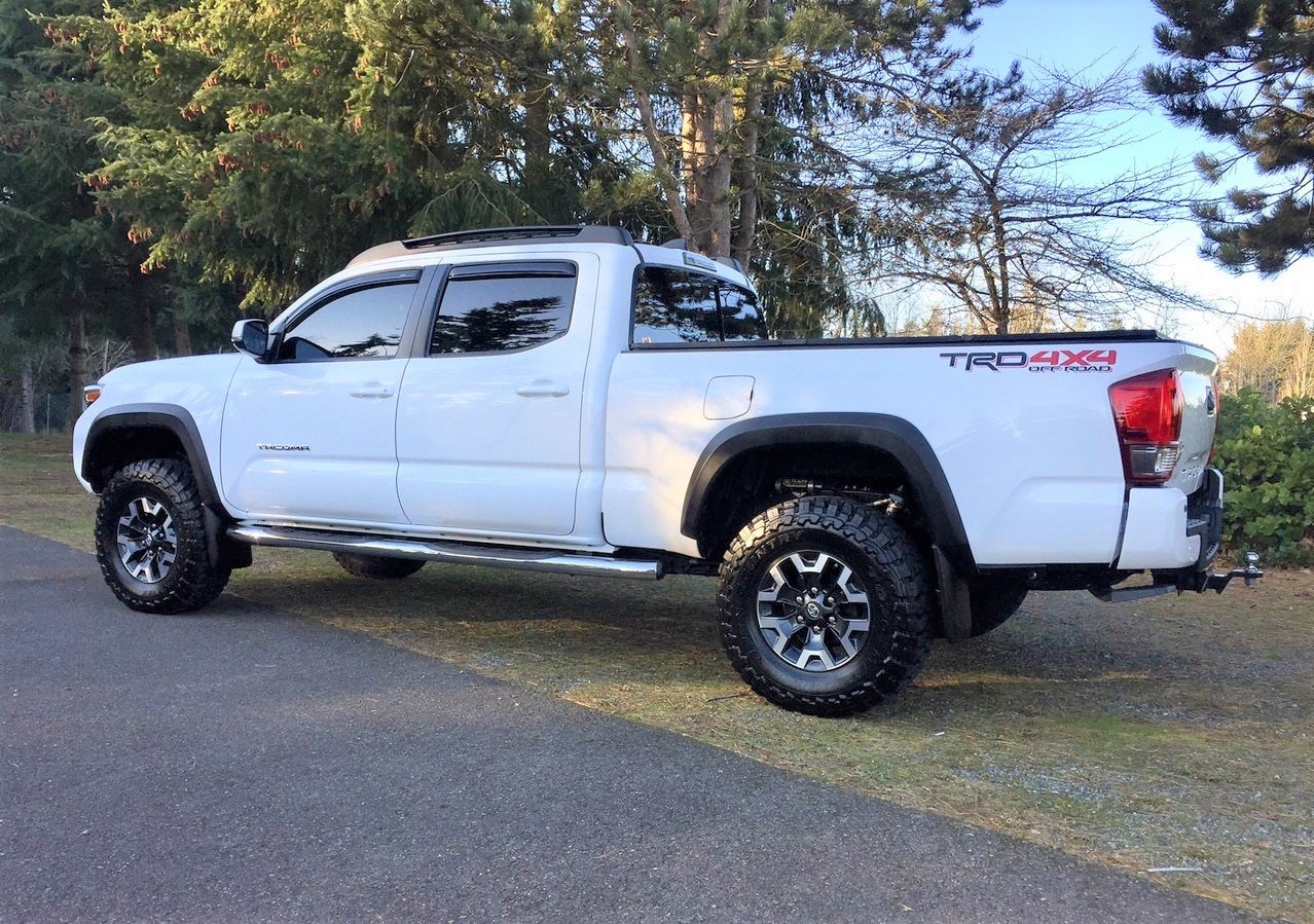

    Leveled with Icon Stage-3 suspension Toyo Open Country MT's, (LT265/75/R16) TRD Performance Exhaust TRD performance Air Intake
    I completely agree...I have the Icon Stage-3 on my 2017 O/R and I think they have been fantastic!
