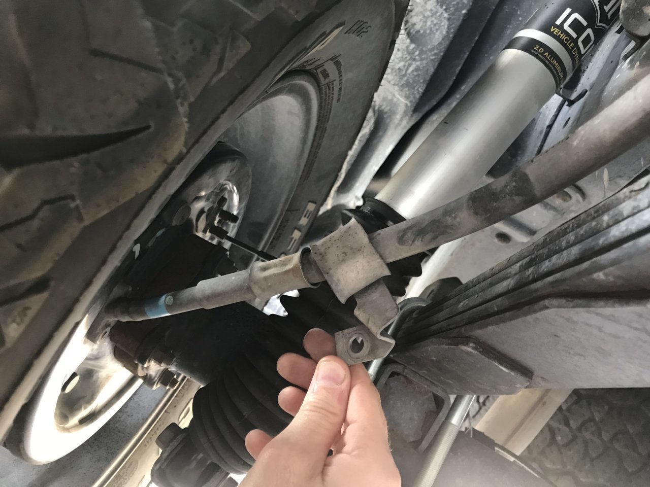

    Hey guys/gals... Looking for some suspension advice/general questions (newb on suspension stuff FYI). I have a 2014 DCSB TRD OR. I had a leveling kit on it (would def listen to the million people who caution against them and say don't bother, too rough of a ride). I just recently got a Stage 2 Icon kit installed. I didn't do any aftermarket UCAs. We took out the overload spring in the rear as per the instructions.
    Just a few random questions... First, the guy that installed my kit left the brake line brackets loose in the rear (see picture). He said most people just leave them off, and he can cut them off, but they are best not reattached as they'll just do more harm than good. I want to confirm that. I did zip tie them for the time being since they were clanking around all over the place and driving me nuts.
