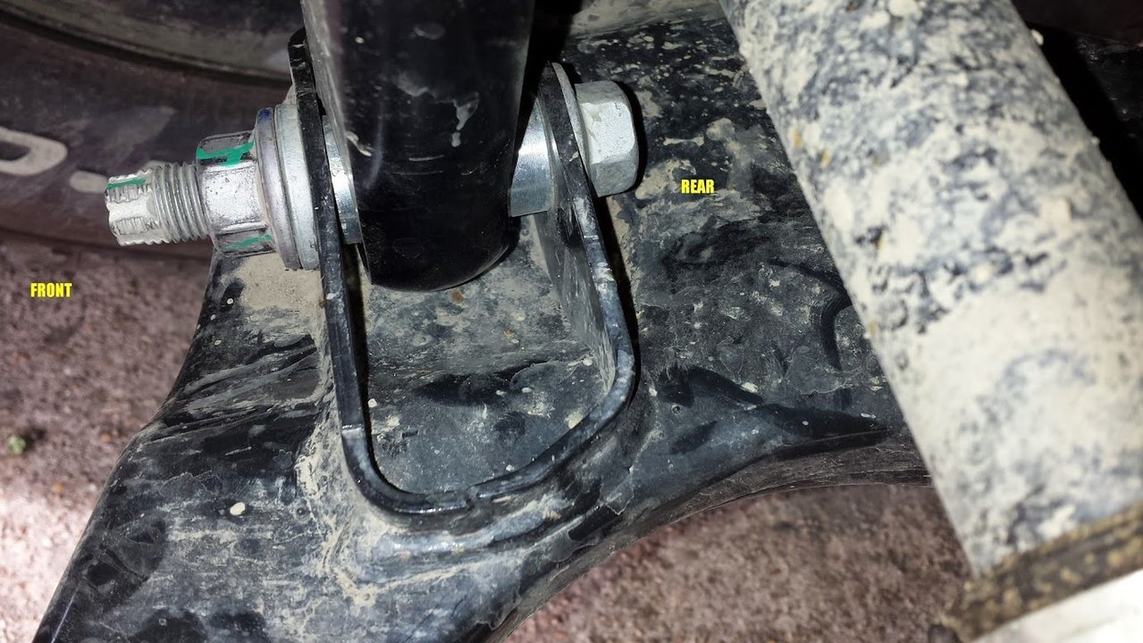

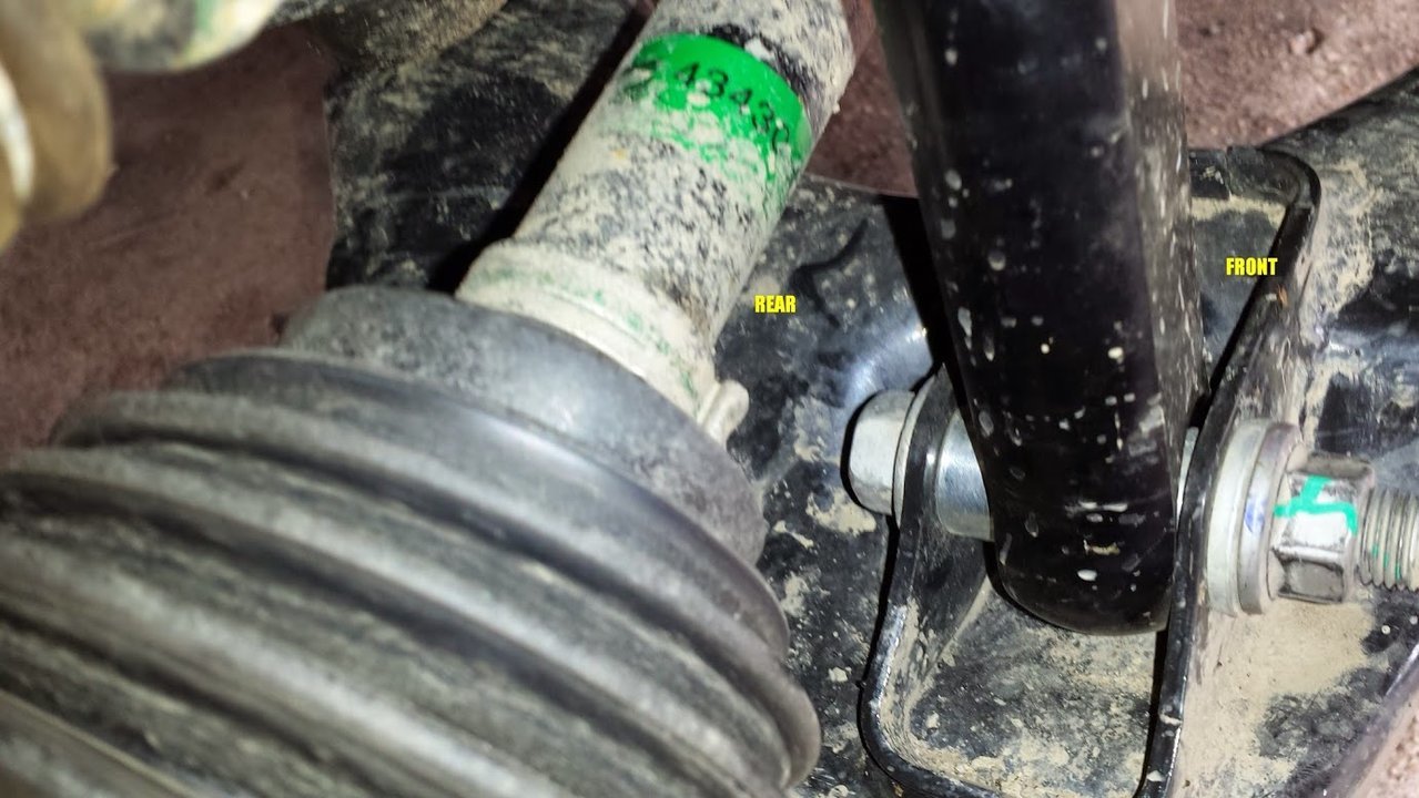

    Make sure the larger bushing is in the front as prescribed, and this will likely eliminate rubbing in the front. But also double-check the anti-sway bar bracket. The Icon instructions are not always provided online by the kit numbers, but the individual components of the kit almost always have instructions online. Finally, had had to have a conversation with the manager of the alignment shop to convince the Tech to align the front as prescribe on Page 1 of this thread.
    The images below show the INCORRECT BUSHING PLACEMENT.
