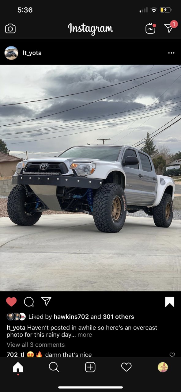

    C8718E47-67D7-4360-8ACB-B6A9DF5A2C48.jpg Can I do something like this with my stage 4?

    That’s a LSK long travel kit pictured on nates Tacoma
