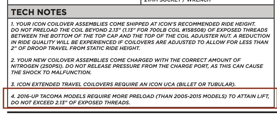

    Saw this in the instructions. Talked to the installer, despite prior claims, he did not adjust, and said they looked good out of the box.

    Problem solved gang.
    Just adjust it a bit.
    Keep in mind that you will need to adjust the driver's side a tad bit more to comp for fuel tank/battery/your butt.

    You increase ride height as weight increases by going to a heavier rate spring, not simply screwing in more preload.
    You're going to get better performance by leaving it adjusted lower and benefiting from the additional down travel. You have pretty small tires, so it's not like clearing things is the issue.

    Move it up to 2 inches and see how you like the ride quality and height. I would stay away from getting close to the max of 2.13.

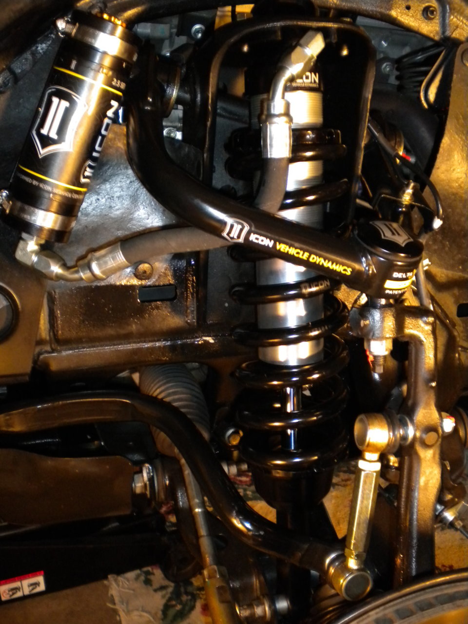

    Not sure if this will help (2nd gen with stage 8.) The coilovers are at factory height for best up/down travel... raised the front 2". If you do adjust i've read the Icon spanner wrench is a piece of shit... better off using a screw driver (cut tip off) or punch with same diameter shaft as the adjustment holes. Your truck looks lifted... how are the cv angles? DSCN0714.jpg
