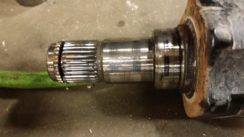

    Something not mentioned yet is the needle bearing. It tends to fail when lifting the truck regardless of which you choose. I recommend ordering a replacement from East Coast Gear Supply and have it installed when doing the lift. You may experience vibrations if you don't replace it. It's not expensive.
    MagneticTaco4x4[OP] likes this.

    This is a great point. I would wait to see if he gets vibrations first, then replace if needed. When I lifted my '15 I had no issues with it.

    all tore up already
    But so much easier to do when everything is already apart. Then you just need to pull the axle instead of undoing a whole corner all over. Plus its cheap and has zero draw back. Not my money or time but i really regret not installing with my lift because i had to do it all over with the bushing a month later. At 7k my axle was already started showing wear from the slop in the needle bearing20161112_130441.jpg
