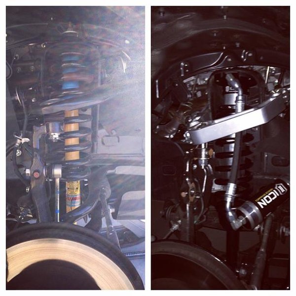

  18. Jun 19, 2014 at 11:50 PM
    #78
    KCCOsavage
    KCCOsavage Member
    May 26, 2014
    #130597
    8
    Corona,CA
    14 PreRunner TRD Offroad
    Icon Stage 4 Kit, Billet Arms
    Good write up!!
    was very useful when installing my stage 4 billet. here are a few before and after. rear wasn't installed yet was waiting on the rear shocks to come in.
