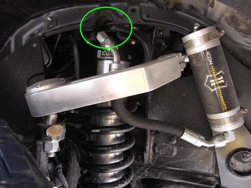

    forgive my ingnorance... the "bucket"???

    coil buckets

    A friend of mine mentioned reinforcing. He's been off road with me once or twice:) I'm going to get the coil when i install, get it aligned and then hit the cams, ending with the spindle in a month or two. Or am I missing something?

    did your shop have to cut the coil bucket and add that little loop at the top? do the 2012 do that from the factory? my 2011 does not, if they cut that out I'm clueless why u would

    I honestly have no Idea. I am not sure what exactly you are referring to. Are you speaking about the little half Loop on the very top of the bucket, right above the Remote Resevoir-90degree output. I did not pay for any fab work or see it on the receipt. Could you circle it??

    this little loop in the coilbucket...pretty sure they added that unless Toyota went crazy with the 2012. I'm not sure why it's cut out. it looks like there was a concern for the hose connector to hit the top? Seems to me you could just turn the connector to clear it.

    Icon had some old Revision parts get mixed up with a the new revision parts.
    The Old version Top Cap had the port located higher on the top cap which required the bucket to get a little trimming/sanding.
    The New Rev Top Cap has the port lower and requires no trimming.

    yep for icons you need to notch that bucket usually and its smart to reinforce it.

    So, does that mean mine was not cut then? Sorry for the ignorance! BTW- I love this suspension and thank you to all of the SDHQ team for putting up with my endless questions via phone and in person!

    Out with the old and kinda mixed up with the new;) welding effect warranty that anyone knows of?
