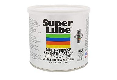

    What grease do y’all recommend to use?

    This is what I use
    irANTHONY[QUOTED][OP] likes this.

    K thanks! Called icon earlier today and they said they use Moly-Fortified grease for both the bushing and delta joint. So I pick up some valvoline
