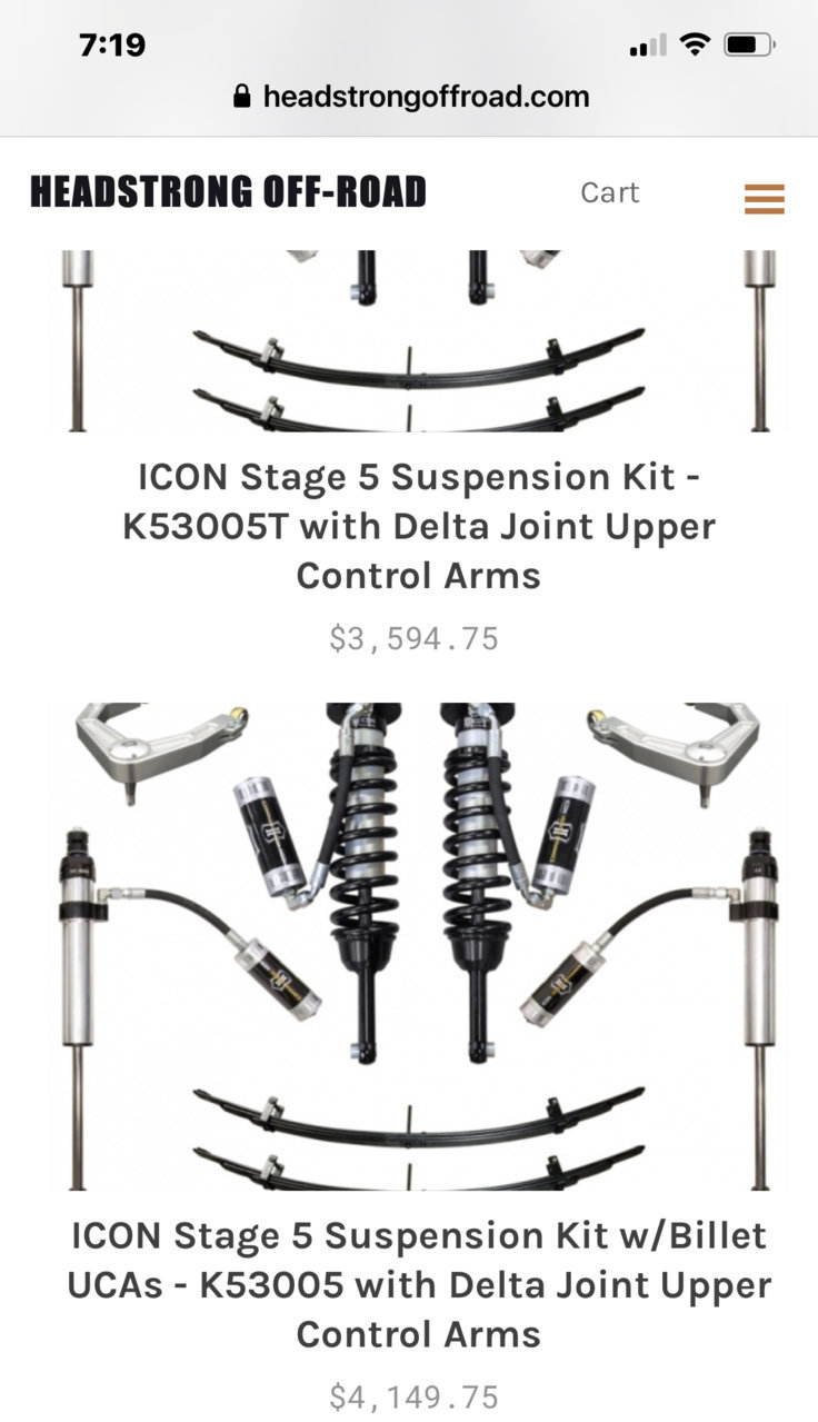

    I have a Tacoma TRD Pro ordered. It will be here Jan 25th. I’m replacing the Fox Suspension as I want more lift and I’m not doing spacers on a Pro. I already have a buyer for the Fox suspension.
    My question is which UCA should I go with. Are the Delta Joint UCA’s good or do I need to get the Billet UCA’s?
    Any help would be appreciated. Thank you!

    Save the money on the UCA’s and put that towards a full leaf pack rather than the AAL in the kit.

    Your money is probably better spent on a kit with the full RXT leaf pack as mentioned above.
    The only benefits of the billet UCA’s are weight and strength. You won’t notice the weight difference at all and you probably wouldn’t need the additional strength of the billet UCA’s unless you’re taking some big hits.

    go with the delta joint tubular UCAs, and see if headstrong will allow you to order the full RXT pack instead of the add-a-leaf option, for an increased charge. They were able to help me out with the same request on their king stage 2 package.

    Tubular UCA's w/ delta joints and the full RXT leaf packs instead of the 3 leaf AAL.

    Which one of these kits would you suggest? With or without UCA’s? If with, which ADD UCA’s would you recommend? I want to do this right. Thanks for you input and help.
