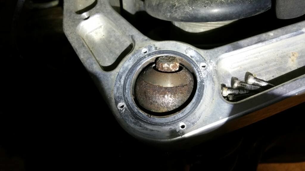

    The caps do more harm than help. The cap prevents moisture inside the cap from evaporating. This allows water on metal to do what it does best...corrode.
    Uniballs are not ball joints. If you're making the switch to uniballs, just know you need to clean your balls when you get them dirty.
    Case in point. 1.5 year old capped uniball

    If they are lubricated they should not look like those in the photo.

    Lube is pretty much the worst thing you can do to heims/uniballs. It attracts dirt and debris and tears the PTFE liner. Wash your balls and deal with the squeaks. If you must use lube, use a dry lube like Triflow or Finish Line. It sets up like wax instead of grease. I live where there's snow, salt, sand, and shit on the road 4-5 months out of the year and still on my original set of uniballs 4 years later with zero pitting or play and I use triflow once a year. It's not complicated. Keep your balls clean and they will serve you well.
    It's not a sealed system. Uniballs are still wide open on the bottom. Gasses rise and condensation forms inside the caps. Driving in the rain, carwash, anything will build up moisture inside the caps.
