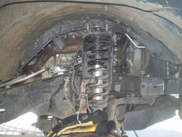

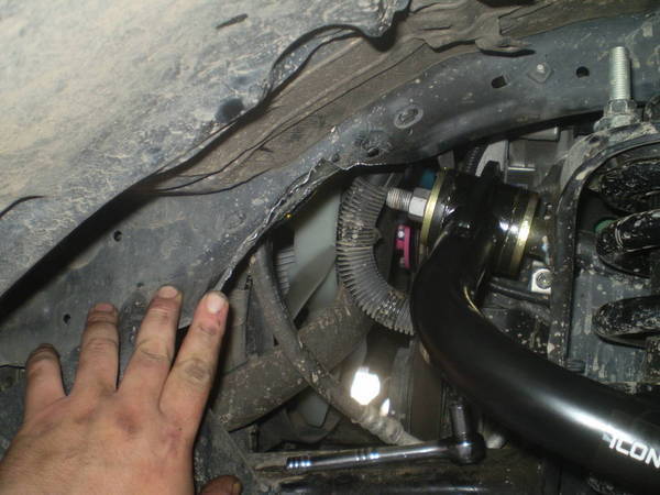

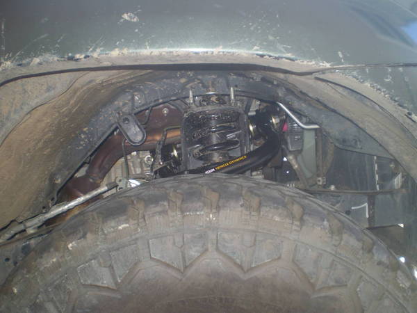

    Just installed the ICON tubular uca's from Demello's GB on my 2nd Gen. Took about 3 hours because I had trouble getting the driver side OEM uniball off the spindle. I did not want to be rough with it, but JLee told me to hit the hell out of it, and it popped right off. After that it was smooth sailing. Here's some pics:
    Driver side metal bending to remove main bolt
    Driver side finished
    Passenger side(used rope, had no bungy cord to support spindle, dont laugh)
    Passenger side finished

    Nice job man BFH FTW :D

    Im getting an allignment in the morning, so I'll see how much they help with that. I like that they are black and blend in under the wheelwell.
