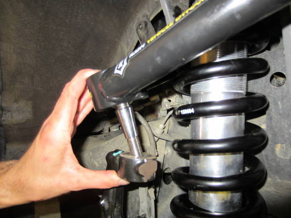

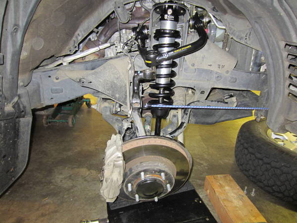

    Yeah first pic is the overall view. Second is of the angle of the taper pin we cant get in

    I used a block of wood and hammer to smack the tapered pin to the correct angle. Then jack the LCA up to seat the pin.

    you mean put a block of wood on the tapered pin and sort of beat it to te angle we need?

    These 1" dia uniballs can be tight when new, because of the teflon liner. Put a deep socket over the pin, attach a 6" extension to the socket for leverage, and move the ball and pin over.
    And yes, expect the steering feel to be slightly worse when done, since the uniball adds that much friction.

    yes, the wood is to protect the tapered pin from dingage. You can use whatever you want to hit the pin, just dont use something that will damage it or the treads. Tap it. It's very tight when new. Mine was

    thanks guys that got it! The deep socket and extentsion got the ball moving for us. We had only tried with our hands with no luck. Almost done now thankfully!
