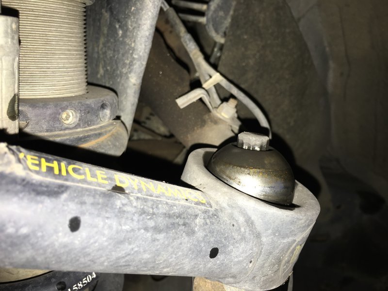

    Has any one had any issues with a unibal on a UCA failing or coming unseated? Just noticed this on my truck.
    Thanks,
    Jeff

    It is a wear item and doesn't last forever. How long has it been on there? It has been bad for a LONG time to go completely through the race. Looks like you have been lubing it, which you are NOT suppose to do. The lube impregnates the Teflon liner and it falls apart, causing premature uniball failure. You bushings will be shit, too as bad as you let the uniballs get.
    Simple fix, buy a uniball repair kit and bushings and replace. Never lube the uniball again, just keep them clean with WATER, no chemicals.

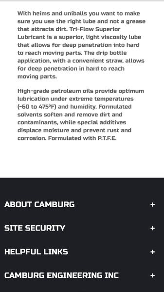

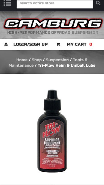

    So Camburg has it all wrong. I understand now. They build their own UCA's and suggest the proper maintenance for their uni ball, ball joint. All this time I thought they had this on their website for shits and giggles! Makes sense! Why do they put this on their website then? We should ask what @Thetequilaworms

    you can lubricate a uniball but only do so if you absolutely have to and only with a dry teflon based lubricant like triflow or belray molylube.

    The internal PTFE liner will over time become dry and fatigued and does have the tendency to become loud. You can "refresh" the liner by using an appropriate lubricant but generally I like to tell people that "Race car parts will make race car noises" and a little noise from your uniballs is normal. It is possible to over saturate the liner causing swelling but it is highly unlikely since dry lubricants do not retain moisture or attract dirt like an oil based will like WD40. Additionally oil based lubricants will destroy and erode the PTFE liner prematurely. The use of triflow or other dry teflon based lubricants is safe for FK uniballs and heims but as you stated the best way to maintain them is simply spending a couple extra minutes during your wash to ensure that any debris is removed as thoroughly as possible.
    The failure above looks like a severely fatigued Uniball through use and normal wear and tear coupled with the use of incorrect lubricants which (discoloration) and due to the extra play the ball itself pushed through the race. The snap ring still appears to be intact which is why the complete uniball assembly has not pushed out of the cup.
