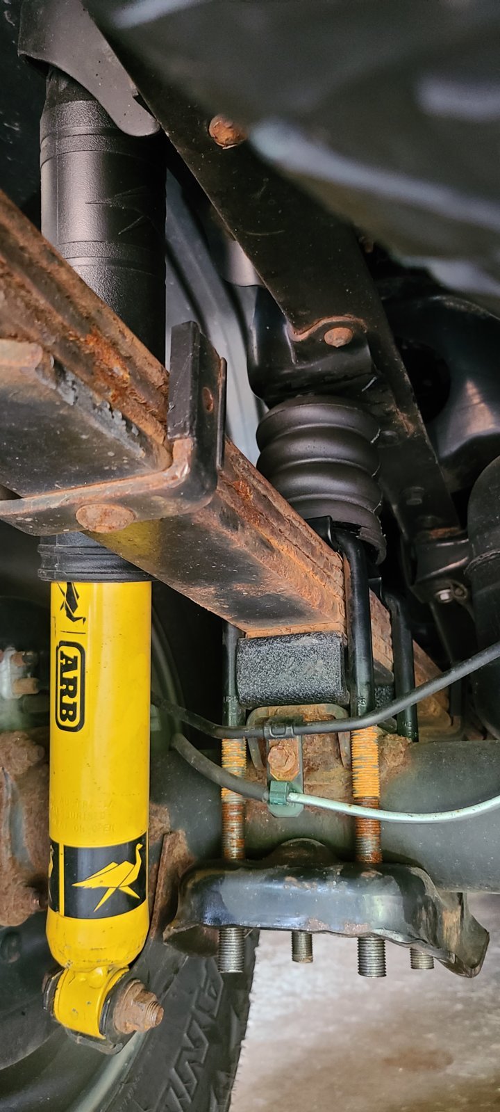

    I have the wheeler's on my 2014, both front and rear w/ u-bolt flip. They are definitely bigger than stock (ofc) and will need a lift to actually get the proper use/clearance. I have a 2.5 inch with a 1.5 inch AAL. I can send some pics later once I get off work.

    If you're referring to the 3rd option then it looks like you should be good. Idk because I didn't replace the whole pack I just added a leaf because I don't have much weight in the back and just wanted to level. That being said, I think the 1.125" lift it provides would suffice but am unsure. I can take some pics and measurements of mine when I get home in a few if you'd like.

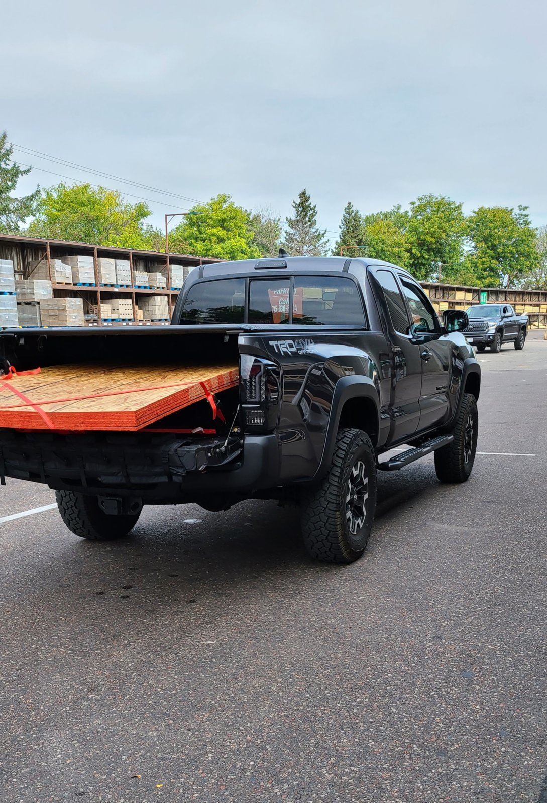

    We're in general talk so here's my '16 with stock leaf pack, 1.5" block and medium sumos springs.
    Over 300#'s in OSB. No sag.
    Sumos are great for my purposes.

    I think Sumo Springs were/are designed more for towing/hauling, hence why they are larger and basically fill the space between the leaf spring and the frame. Timbren/Wheeler's were/are designed more for offroad use since they don't fill that space allowing for more up travel. But idk that's just my two cents, I could be wrong. :notsure:

    I agree.
    Travel limit will decrease some, Idk the max but they do compress to at least 50%, I believe. The amount of travel lost can't be much.

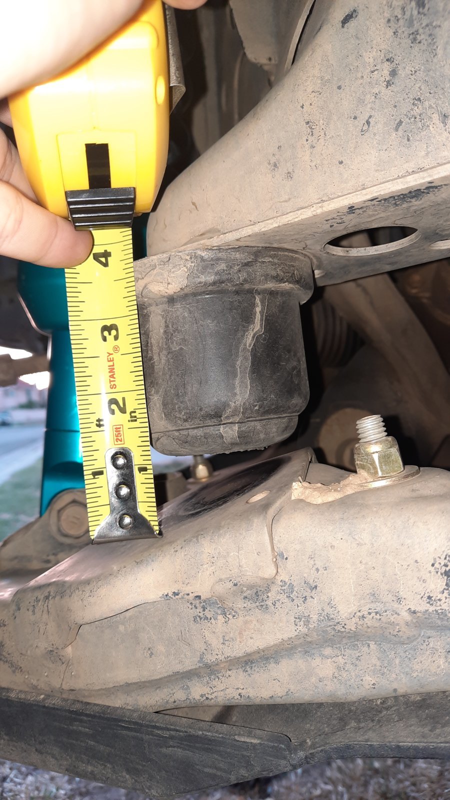

  14. Oct 21, 2023 at 7:09 PM

    The OEM rear bumpstop is bonded to a steel sheet, which is in turn clamped under the U-bolts. The Icons are "universal" i.e. you have to figure out a mounting scheme yourself. In the rear this means drilling a hole on each side of the frame and mounting these bumpstops with nuts and bolts. You'll also need a strike plate like this: https://www.tacomaworld.com/threads/bump-stops-too-short.457376/#post-13512581

    Wow that is not much clearance on the front bump stop. Do those limit your travel compared to stock?

    TBH, no, I don't notice any travel limit. It is way smoother when I hit dips and bumps and I no longer hear the "clunk" when you would hit the stock bump stop.
