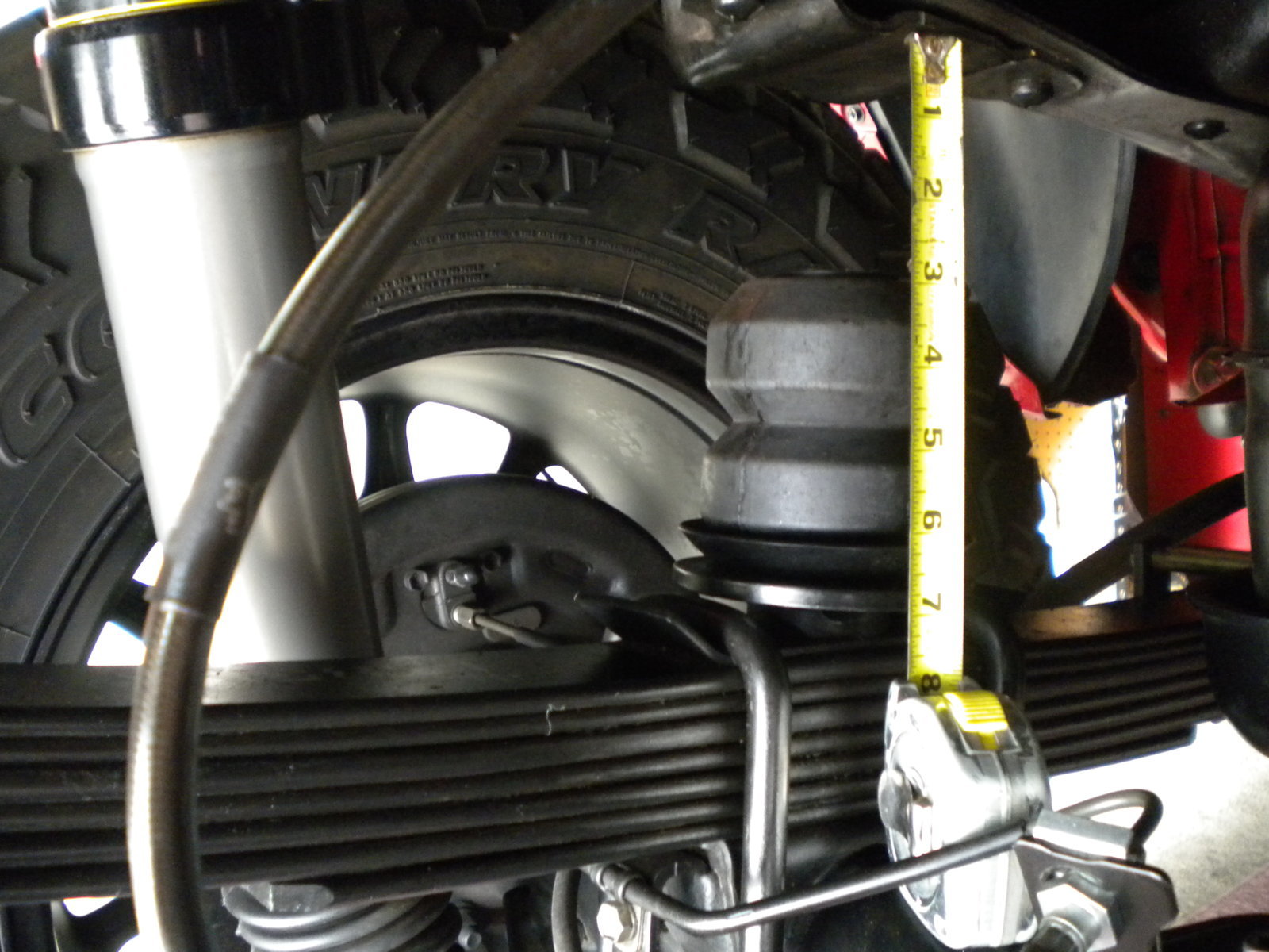

    I had superbumps like those you quoted. In the rear of my Tacoma they definitely limited travel, and I would bottom out much faster over dips/off road. I went back to stock bumps and no issues.

    It was on ome Dakar medium leaf springs. About 2.5" rear lift. Most people don't have any issues. But as you can see by the photo posted that huge bumpstop takes up a lot of space.

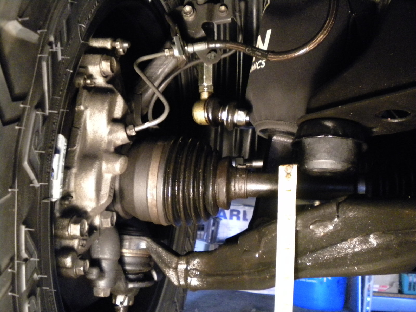

    Not sure if this will help (gen 2) but this is Timbren Offroad bump stops, Icon rxt leaf pack at option 2, SnugTop canopy/spare in bed. 2" lift front/back... center hub to fender 22" front/24" rear.
