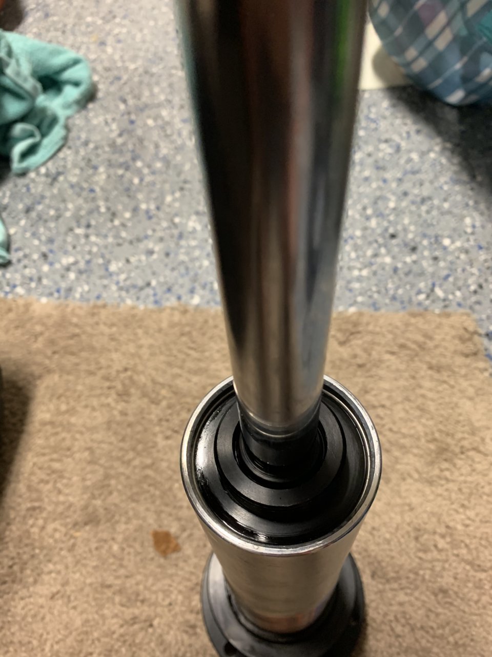

    I have a Question For anyone who has rebuilt multiple shocks. Is it normal for a little oil to seep out of the bottom On the outside edges of the bearing housing (the part you change all the seals in), just under the retainer C clip once you get everything put back together AND you push the shock stem down like it is cycling BEFORE you ever fill it with nitrogen?
    Just wondering cause this is my first rebuild on my Icons and these are the 2.5 non resi fronts. I rebuilt them yesterday and figured once I filled them with nitrogen then it would put pressure on the bearing housing to push back up against the C clip retaining ring and the O ring around the bearing housing (or whatever it’s called) and it would seal off tight at that point.
    just wondering before I waste my time going somewhere to get it filled as if it is not supposed to seep a little at all then I need to figure out something else. I reseated it several times yesterday and it always seeps.
    Any comments?
    Again there is no pressure in this yet.
    Here is a picture, dust end cap not on just looking down, very very little oil will seep if I try to cycle with no nitrogen in it.

    A little is ok as long as once the shock is fully charged it stops seeping. Clean the area and let sit for 10 min. If anymore leaks, you may have a problem. Icon shock charge pressure is 250psi.
  10. Jul 17, 2020 at 8:25 AM
    #50
    slcsez2000
    slcsez2000 Well-Known Member
    Jul 16, 2012
    #82775
    7,275
    St Aug, FL
    12 TRD Sport 4x4
    Exterior: -Current Suspension- Icon extended travel front struts w/ 700lb coils Icon extended travel Remote Resi rear shocks Dakar leaf pack Icon Tubular UCAs with covers Icon neoprene shock covers -OEM Roof Rack -2 fold down cup holders in bed -Bed bottle opener -Access lite rider roll up tonneau cover -AFE Prodry air filter -Pop and lock bed lock -Rear differential breather relocation mod (behind tail light) -Aeroturbine 2525XL Muffler Armor: -SOS Concepts bolt on sliders W/ kick out -SOS Concepts aluminum front bumper with full hoops -SOS Concepts Rear HC Bumper -SOS Concepts IFS/Mid skids
    Thanks!
