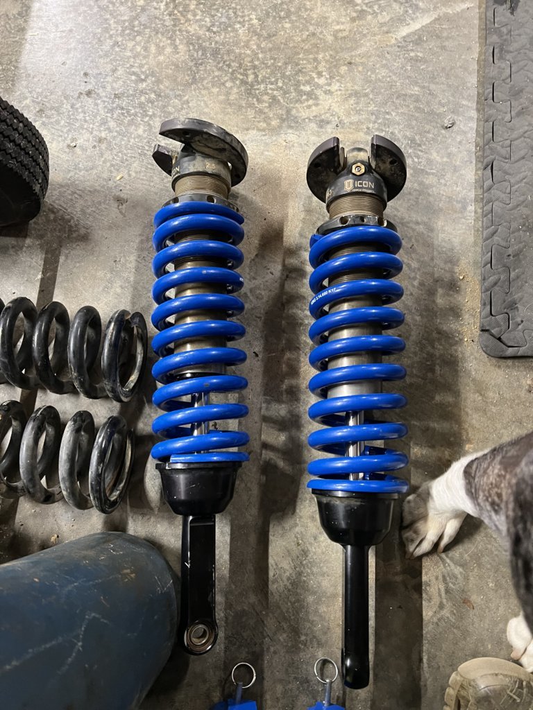

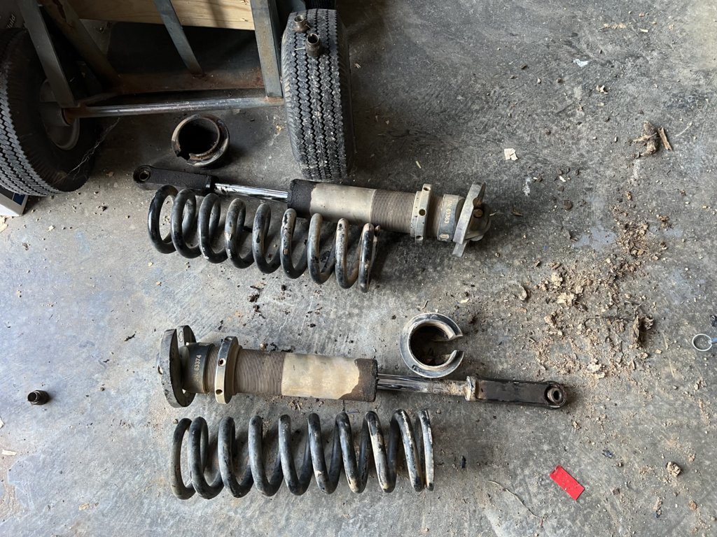

    A couple of rear window decals...
    Thanks for the right up. It was very helpful in rebuilding my ICONs this weekend.
