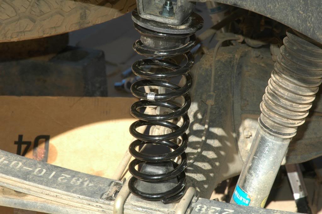

    if you don't want to run the overload leaf, you can always add-a-coil when you need to carry a good bit of weight. ...the great thing about the add-a-coil is that you can remove it easily when you're not hauling anything.
    all you do is slip the coil over the rubber nub on the ubolt top plate and then slip it over your bumpstops. ...i think i'm using 125# 10" springs and i litteraly can't overload them. i've hauled palates of tile as well as a bed full of fresh cut oak. ..works like a charm.

    i didn't use any hardware. ..i just slipped them over my extended bump stops. the weight of the bed keeps them in place.
    now, you don't want to go offroading with this setup because during articulation, they could fall out ..but if you're using the add-a-coil only when you need to haul a heavy load, you'll never have a problem.
