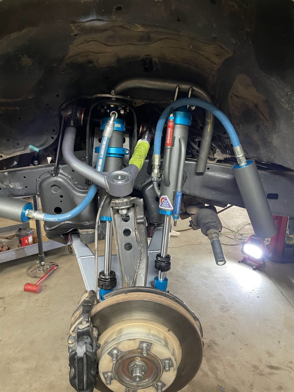

    Has anyone run these on a LT kit?

    I wouldn’t want them on the lowers, but uppers ought to be ok

    On the uppers is what I was thinking @Texoma

    They worked on my TC +3.5 kit on my 1st gen. I recommend cycling your suspension to verify nothing binds.

    What are those shock saver looking cushion things?

    King shaft bumps

    Bumping this thread, does anyone know if the fit kit 614526 - adapter kit is needed with Camburgs or will the slug adapter from Camburg that’s pressed into the spindle work?
    got my answer, it’s needed
