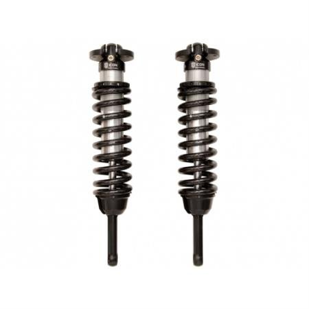

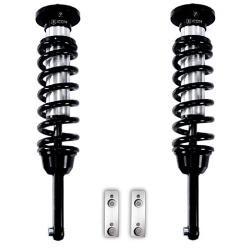

    Yes, they did. The old ones had a complete top portion, to evenly distribute force:
    In order to gain more travel, or whatever, they moved the shock up, and made a "C" type top mount:
    This unevenly distributes force into the shock mount, creating the issue the OP is describing.

    well shit they sent out the old top hat design to me, not the new one!

    Yup. The new design isn't a good one.

    In case I wasn't clear, the OLD design was complete circle. The NEW Design is the "C" style.

    The Redesigned one is the one you have. The old one didn't have issues.....well...not like that anyway.

    Ah got it! Like Donahue racing design or icon design ( the old one)
