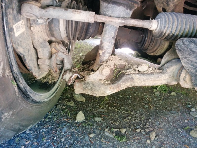

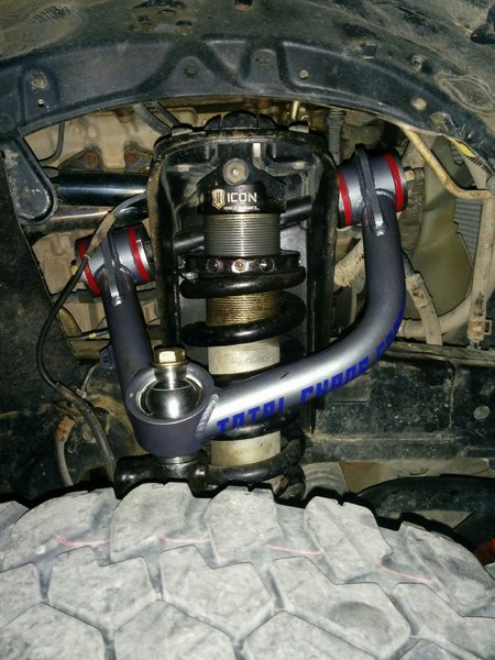

    I went off the road at a 90° turn on a gravel logging road, the front right tire took the brunt of the impact. I actually broke the lower control arm, and the icon shock was unphased. Not bent, not blown, no top hat breakage, not a damn thing was wrong with the shock. Upper shock bucket is not deformed either. Preload shown in last pic with 650# coils. I have since installed 700# coils. Never experienced any coil binding during suspension cycle.
