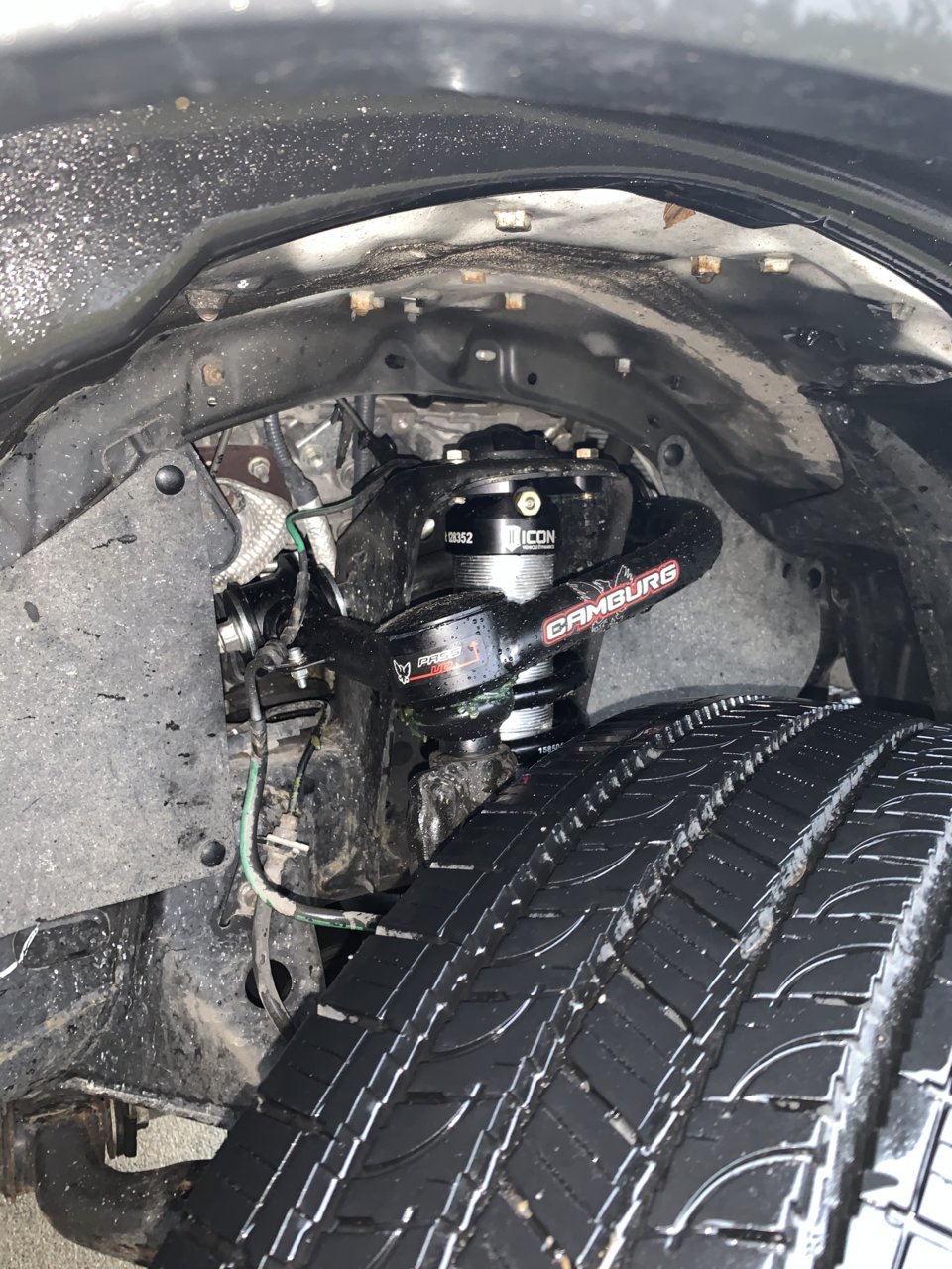

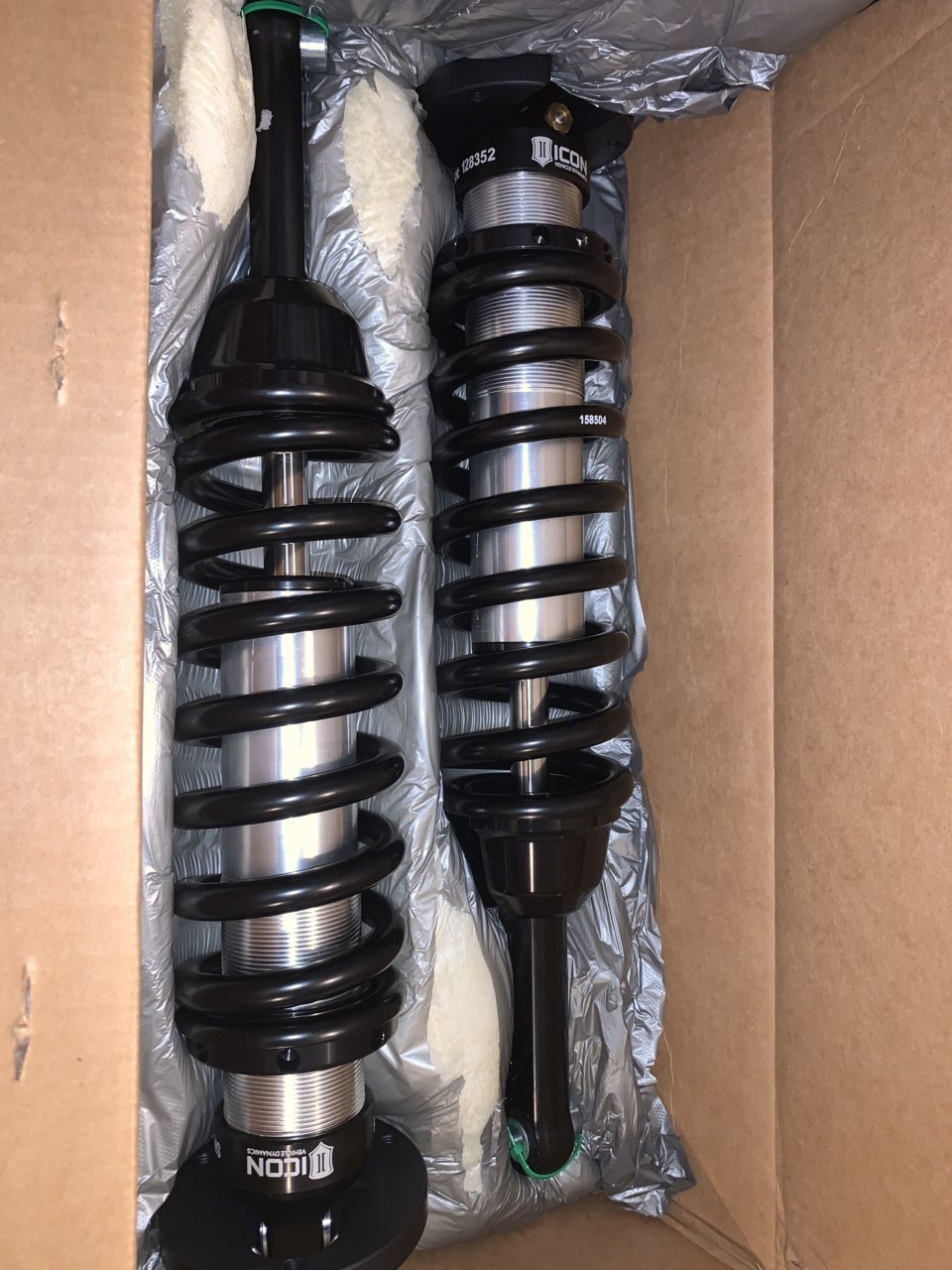

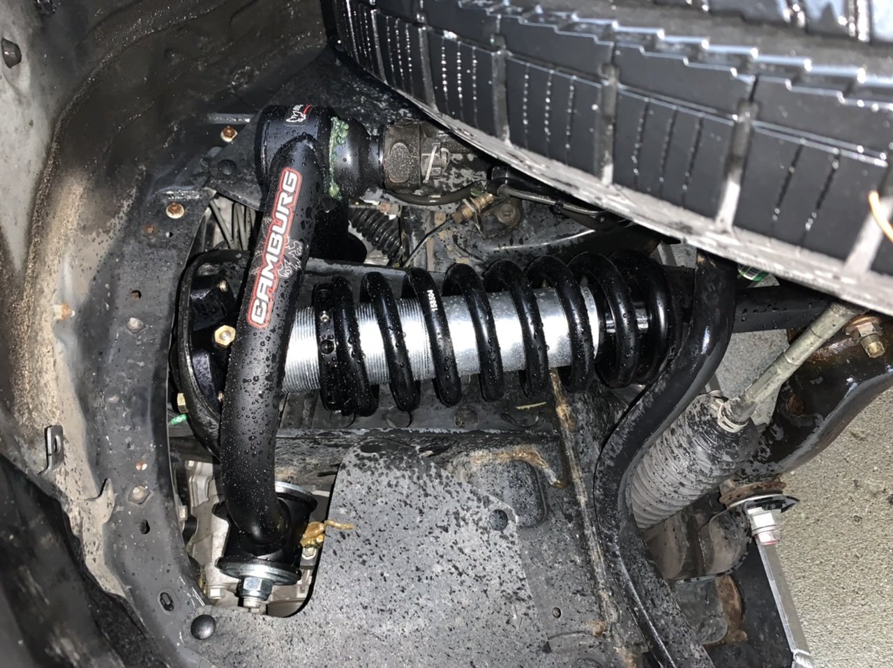

    They came in earlier this week. At the shop now and should be picking up this afternoon. Basically Icon Stage 1.5 lol. Icon Stage 1 kit with Camburg Moog Ball Joint UCA’s. Will let y’all know how they ride after a few days. Also any suggestions as to what to spray them with to keep corrosion at bay? I didn’t change the preset so hopefully won’t have too bad of a Cali lean. If they do I may just say screw it and get the add a leaf and toss it on myself.

    First impressions are really good. Rides comfortably but not soft, has good road manors and really took away most of the body roll and nose dive. I took a turn a little fast cuz it felt good and slid a bit. Didn’t do an alignment yet but even with the 1.5” lift in front doesn’t feel like it needs one (I’ll still be getting it aligned though). When hitting larger bumps on road it eats them up and little bumps don’t feel rough at all. Will hopefully take off road in next few weeks and can give some feed back when I do. I’m impressed so far. Time will tell the rest.

    Icons are good in that they use a one-piece spring collar that you can adjust easily in-situ. Just jack up the front end by the frame, spray some lubricant on the spring collar and where the lower spring seat sits on the shaft end fitting, then crank away with the spanner wrench.
    I removed the sway bar so the Taco Lean was very noticeable. I preloaded my driver's side coil 1/4" more than the passenger side coil to keep the truck level.
    Spray with Fluid Film around the spring collar threads to slow down rust. That's the only place where rust develops. The shaft is nitrided (as opposed to chrome plated) so it'll never chip.

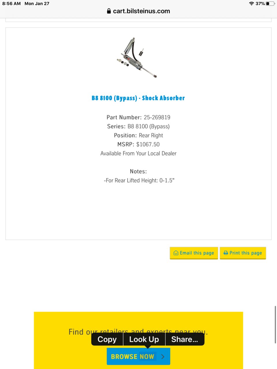

    Over $1000 a shock ??? Is that correct ???:spending:

    That’s about $4500 w/o rear leafs . I think my 6112s ,TC UCAs , Dakar’s , and 5125s were around $2200 total give or take a few bucks .
