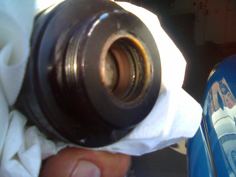

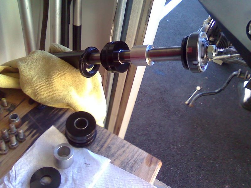

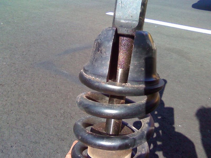

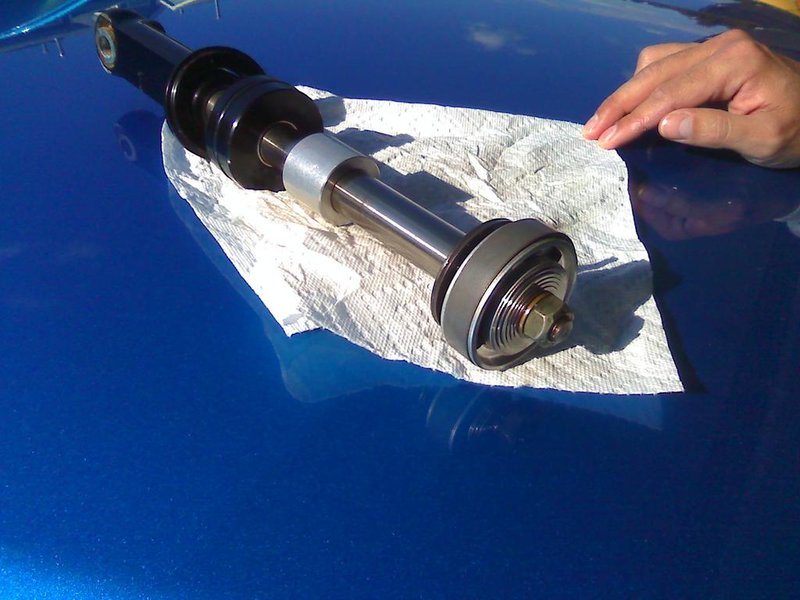

    Just checked the right side shock also. Friday night it had just a slight film of oil (what I consider normal). Today I checked again oil all over the shock the same as the left side. All I did yesterday is -200 miles on the highway. Are the new tires 285/75/16 that harsh on these shocks ????. Ohhh men , am I PISSED. Spent all this money and a year latter I have to put more time and money ???
    If there will be only one ?? yes is a fluke. But two ???
    I took some pics of the shocks and the internals. Really no science to take them apart and rebuilt them if you are a little bit mechanically incline.
    The only thing that will need someone for is- Nitrogen fill up. U need 250 psi and as close is possible.
    #1- pic of the second (right side)shock leak,
    #2-pic of the internal
    #4 - pic of the second seal that is leaking. You can see the dirt right inside the seal

    I have no problem doing my self. If you look at my pics in post #31 ,, I all ready took everything apart and ready to install it back. I am just waiting to see if ICON's is willing to share the bill. The shafts (both) and new seals all around is a pretty steep bill after only one year of usage on the highway. Don't you think ???
    Hopefully they will help with the parts ??? Is going to be a loooong night.
