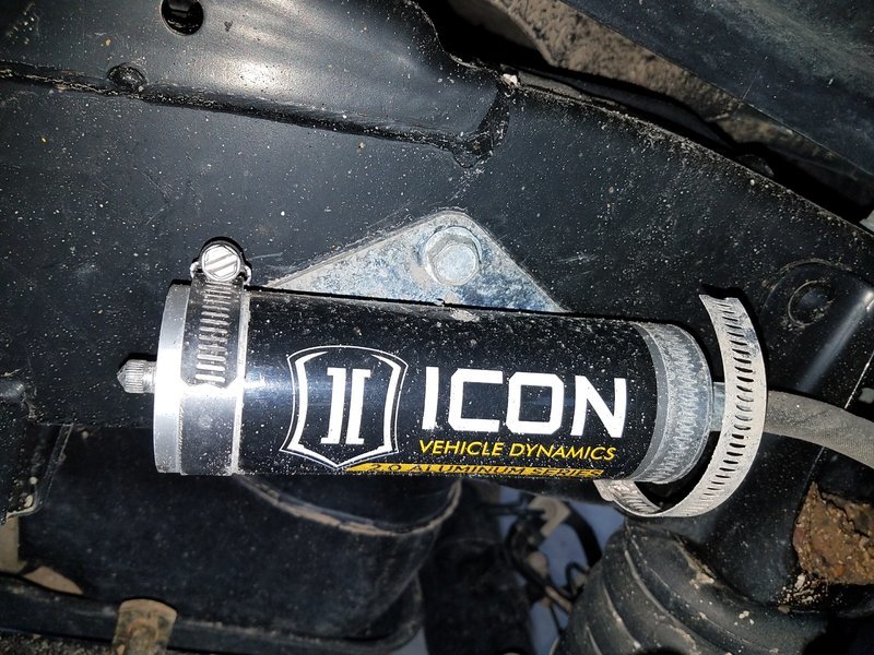

    Broke another one. Anyone have any ideas what the hell I'm doing wrong . 20170317_070937.jpg

    To me, it looks as if the nose of your resi is trying to move up/down/out and stressing the front clamp.
    Loosen the bolt that holds the bracket the resi mounts to. Let the bracket/resi adjust itself and then retighten it.

    How hard you cranking those down? Dont see movement or stress since the top of the shock and res are both frame mounted. Just a cheap regular hose clamp? Id think they would be up to the task of holding up a res. Measure the outside diameter of the res and see if some bilstein aluminum brackets would work?

    Maybe the clamps are routed thru the bracket in a way that they're rubbing against the frame of the truck or somehow getting pinched and wearing that way?

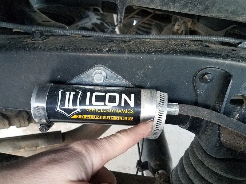

    nevadabugle[OP] likes this.
