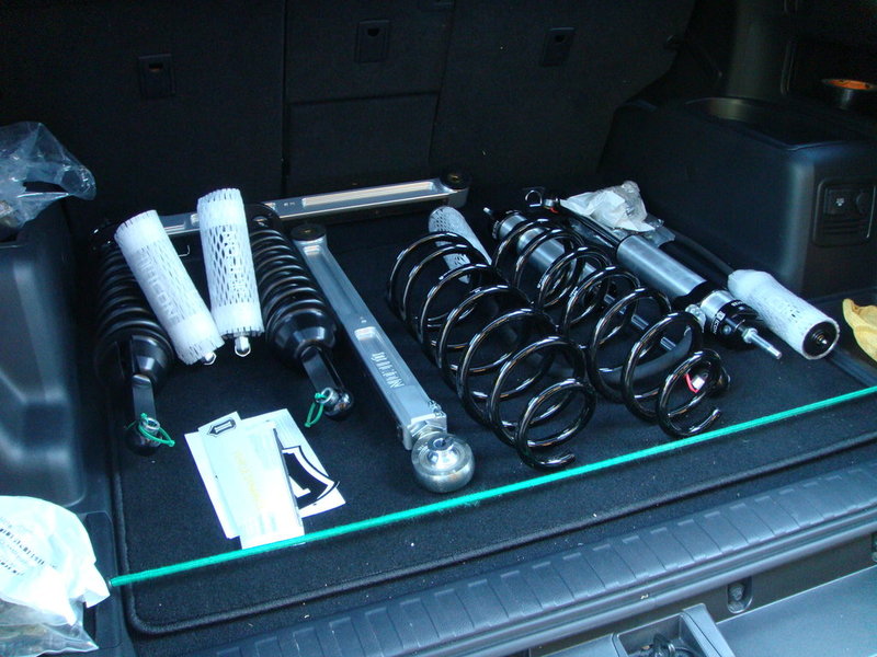

    anybody have experience installing an Icon stage5 on a 4runner? Just picked up the kit going in soon. any tips or advice in installing them would be greatly appreciated.DSC02016.jpg

    those come from icons at their recommended ride height. do you know if there is a lean like the taco lean? if so i'll have to get the spanner wrench to adjust it.

    Also, set the links 1/2" longer than stock. Use rachetstraps to realign, only remove one side at a time.

    If you know someone who owns a race shop or scales, you can then corner balance which will make it handle soon much better.
