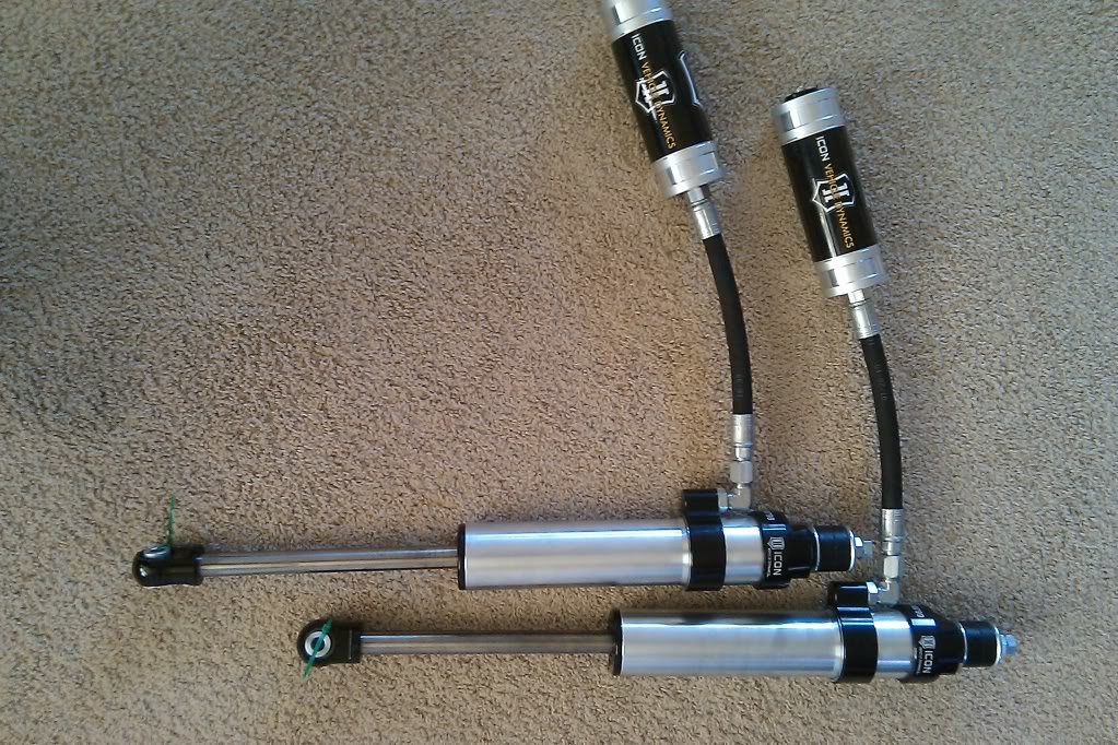

    if you do get icons... only get the new 2.5 shocks... the ones in the pic above
    the 2.0 resi shocks are crap. old donahoe tech... which were basically rebaged edelbrock shocks

    Icon is making a 2.0 vs series remote resi for our trucks i heard, though

    i'm talking about the 2.0's you can buy right now. those suck
    Icon's new 2.0 shock will be an entirely new shock and i'm sure it will be light years ahead of the current 2.0's they offer
