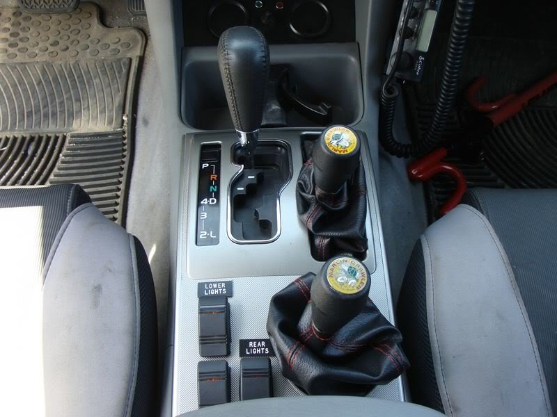

    I don't think I mentioned anything about a twin stick case in that post. In fact I had just an FJ Case and crawler that wasn't twined first then twined the FJ case.
    Now if you wanna doubt me about the strength of the FJ case compaired to the geared case or the lefty, you'll be out of your mind. That geared case can't hold a candle to the FJ Case for strength. Not even the beefed up case's from Marlin and inchworm. The case themselves start to break where the FJ case wont. They are super thin unless you use the big case from Advance Adapters and then build your case from there. But then you still have to build it up with all the Marlin goodies to get it as strong as the FJ case is. Plus, the FJ is a ton cheaper than the lefty or the beefed up geared case and if you want to have the flexability with a crawler you have to add that price in the equation.
    I've looked at all the options and witnessed them first hand as well. Your not beating the Marlin Crawler Taco box and FJ Cruiser T Case combination for strength and flexability unless you go to the Atlas four speed and I've seen a number of those blow up under these trucks and FJ's as well.

    Sorry, didn't mean to come across as doubting you. As soon as you said the lefty was weaker, the idea went way out the window (not that it was really in the window to begin with haha).
    How does the Taco case compare to the FJ case in terms of strength? I understand some of the other differences already, like about the shift rails not being split on the Taco case and such (I followed that thread several months ago about the guy arguing that you could twin stick the oem taco case and listed a way or two to do it, upon which you went into detail about why none of those ways would work. haha. Was quite comical:thumbsup:)
    The strength is more what I am interested in. Mostly I just see people go to the FJ case just to get the twin stick and I don't see the point in dropping about $1K on a tcase just for twin sticks, when you already have a working, pretty much equivalent (as far as I know, and minus the split shift rails) tcase in your Tacoma. The 2nd reason people get an fj case is the reliability of a hand shift instead of an actuator, well Taco cases can run a single stick, I've seen a few of them on here, in fact I think I recall you doing one.
    So basically the two main reasons I see people get fj cases are more or less met with the Taco tcase, or at least not worth the extra $1Kish that FJ cases are going for.
