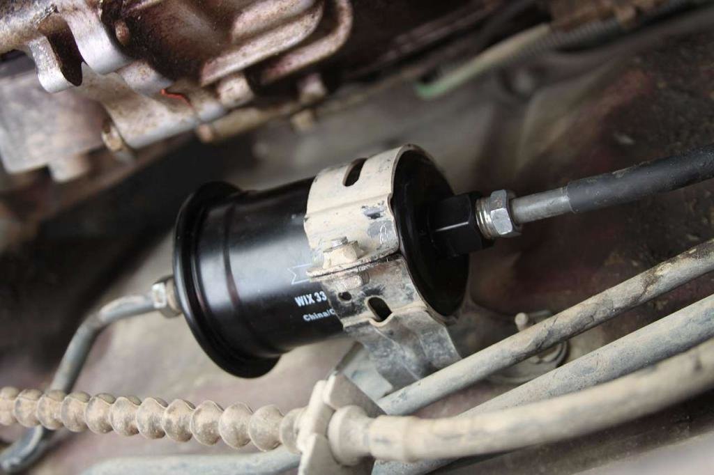

    From my fuel filter today.

    I did mine in the just this fall. Original after 230,000 miles i think. But i didnt drain it. Just three pointed it into the trash can:cool:
    The fittings were super rusted so i was very careful. But a really easy job

    The fuel lines are rigid and they fit in very deep into each end of the filter, so it was a little tricky getting the fuel lines far enough apart to take the old one out and the new one in. Besides that it wasn't too bad.
    You will need a 10, 14 and 19 mm open end wrenches.

    My fittings were a lot rustier than yours wow ^^
    I guess thats what i get for living up here
