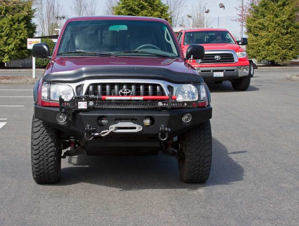

    A full set of BBs will add about 120 lbs.
    Do it! It'll look awesome, not sure about the aerodynamic qualities tho.
    Not on a hoop and didn't drive across country either
    IMG_2949_f6aee316c8d7c4863b729acecf1507d905982b7e.jpg[/URL]

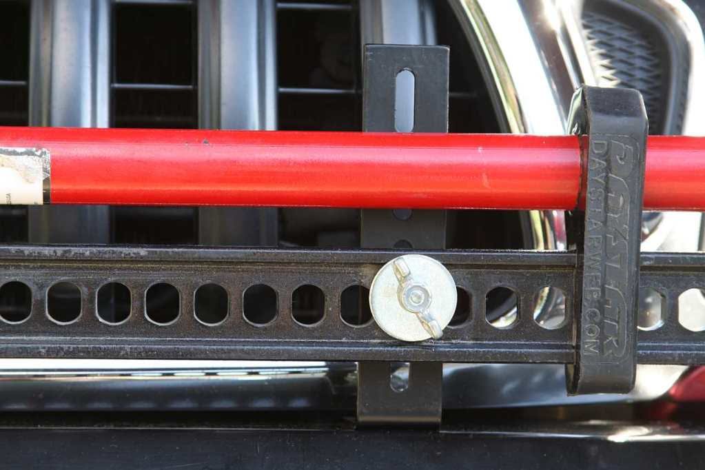

    I wouldn't use wind nuts. You can get nuts that are basically plastic handles. Much nicer.

    Just easier to handle. And torque down and loosen. Plus they don't corrode as much.
    Jon had wing nuts holding his hi lift on his CBI bed tire rack thing. Was a PITA to take it off

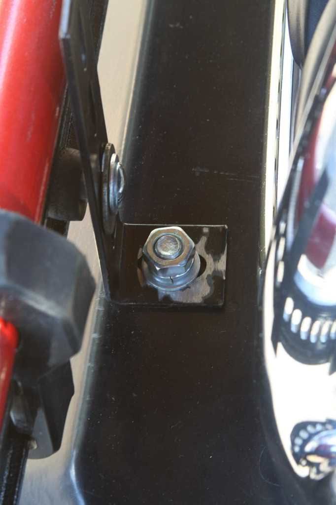

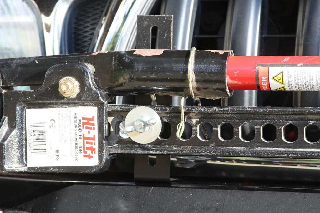

    Wing nuts work just fine and are cheap and easy to use. I also put some rubber grommets on eithe side of the hi lift to eliminate rattling/vibration noise. Not certain it was necessary tho.

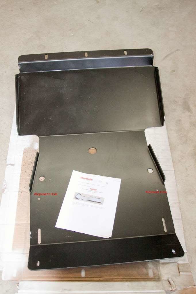

    I figure there is a greater chance of catching on a rock with a large hole. Not sure how big the skid row one is but some are 4-5" in diameter. Also seems like it potentially could weaken the skid too.

    Weaken it..possibly. But the front skid has the lower frame right there behind it so it doesn't have to be as stout.
    Rock getting in there could maybe happen though.
    I'd just get used to taking it off like you said. Mine won't have a hole at all.

    The hole lines up exactly. It is designed as a drain hole for sure. I still take them off evry 5000 miles.
