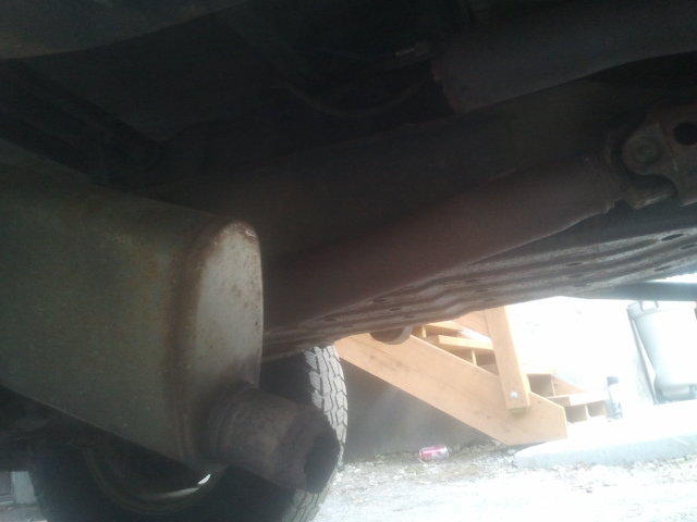

    Almost lost my magnaflow today. Straight piping now boys hahaha braaaap

    my truck is so loud now haha. Sounds like a nasty chokemaster 40

    Mine is loud now too! The Y-pipe is banging off the rear skid pretty much all the time now. I need to take that skid off and figure out if I bent it or broke an exhaust hanger or what.

    Mine was hanging from the hanger :eek:
