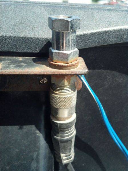

    Oh? I was planning on a spring rated for a 5'+ antenna.
    The K4 is the name of your antenna mount (they are called studs). The PL259 connector is what connects to the back of the cb but there are two kinds of studs, ring mount and pl259 mount (i don't know what they are officially called). One uses a ring that is held in place and the other uses the same pl259 connector to connect to the stud. I think monte has a ring mount style. I went with the pl259 style.

    You cable just has to match your stud.
    Notice how my cable just threads onto that stud just like it will on the back of the cb.
    Google ring mount cb stud or something to see what a ring mount looks like. I'm on my phone or I would post one here.

    I would need this then, correct?
    http://www.amazon.com/FireStik-K-4A-STUD-SO-239-CONN/dp/B0002HRBSU/ref=sr_1_1?s=electronics&ie=UTF8&qid=1373653782&sr=1-1&keywords=pl259+stud

    That mount works for cables with pl259 connectors on both ends yes.
    I don't know if that style or ring mount is better or if one even is better, just wanted to make sure you were aware of the two different stud types so you got the matching cable and stud.

    One way to look at it is a ring mount style mounts the cable 90* to the stud so you wouldn't need an elbow there. In my case I didn't want a 90* angle there I wanted it straight. So it will depend on how you mount the antenna really.
