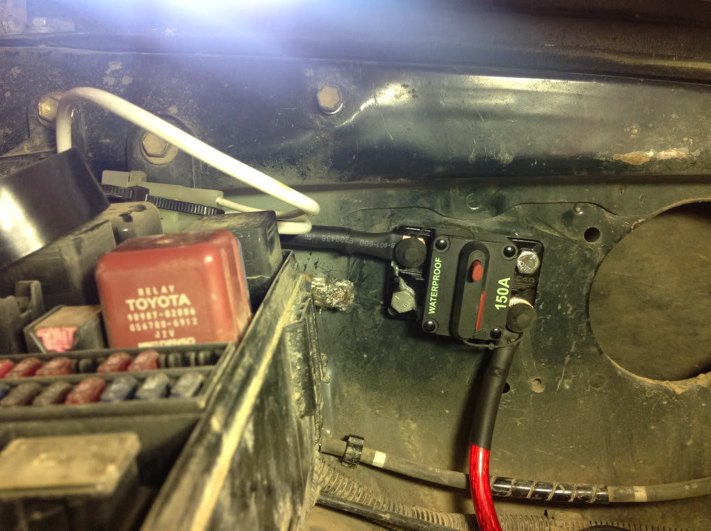

    For a kill switch I'd just intercept the power wire r even better then ground wire of the starter. Just put a relay on that.
    If your a manual tho I'd do it on the power wire to the ecu. Resets the ecu which isn't great..but then they can't push start it if your really worried.
    Radio like the headunit itself?? I have all amps so they go n my aux battery. The hu doesn't pull enough to really worry about it. But ya just run the power wire from it to the aux battery. Which if its a stock radio will take a but of effort. But mine is aftermarket so I know I could do it fairly easy.
    For the primary battery. I'd go get a big 150a breaker like so.
    5f97f523731192c92e8459b2cf3591fb_zps992b_4d253aed5302c9232d194a5e38515eae5cd06d66.jpg
    Put it on the ground cable and mount the breaker in the fender well like I did. Battery hides it great. But you can still hit the switch amd reset it. Just pop off the breaker when you don't want to take the chance.
    You'd have to run the other grounds to the body, starter, frame and motor off the post of the breaker. Or you could get a distribution block for a cleaner look.
