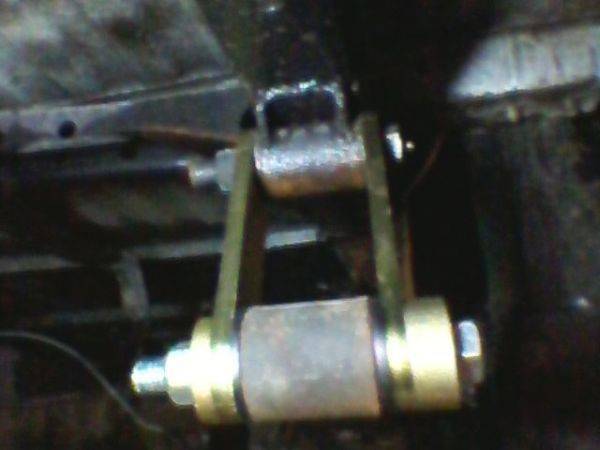

    These AP shackles have me confusid

    Is it something to do with the way the bushings fit the spring?

    should have the solid "spacer" part go on the leaf side.

    Sent a pic to live.

    what's wrong with it?
    Ive put on and taken mine off several times

    I think AP sent me the wrong bolts. They are way too long. I think the spacers and top bolt for spring hanger are meant for stock Tacoma hangers. I have the AP hangers that are only 2" wide

    is this it?
    the alignment spacers are supposed to go inside the shackle, and the bolts don't have grease zerks?
    but im not sure the difference between the AP hangar and the stock hangar

    yep. That would be it haha

    oh
    but yeah, might be the wrong bolts. give em a call

    Not the wrong bolts.
    His hangers are different. They are usually wider then the leafs. Thats what the spacers are for of if you look at OME or Toytech shackles they bend inwards.
    his aren't, his are narrower

    Well looks like im running it like this untill I get shorter bolts... Only reason im using the spacers is cause there isn't enough thread on the bolts

    you'll probably have to get your own bolt.

    You'd think they would sell a bolt that works with their OWN hanger....
