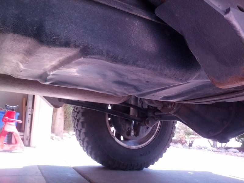

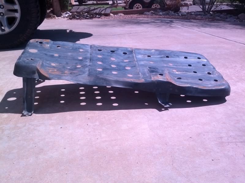

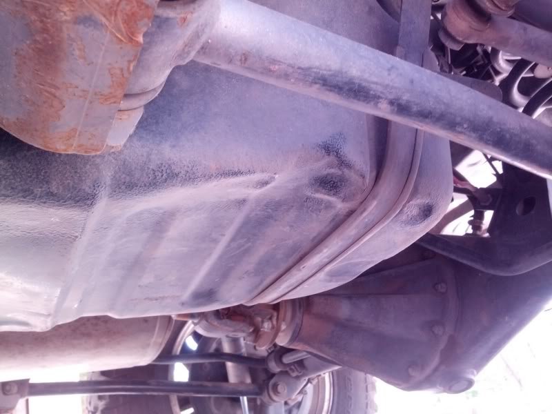

    I plan to get the low range skid depending on the thickness of the metal. Buddy of mine bent his stock one on his 4runner so bad that it dented the gas tank. He took the stock one off and just reinforced it. My stock skid is already bent up against the tank at the front.

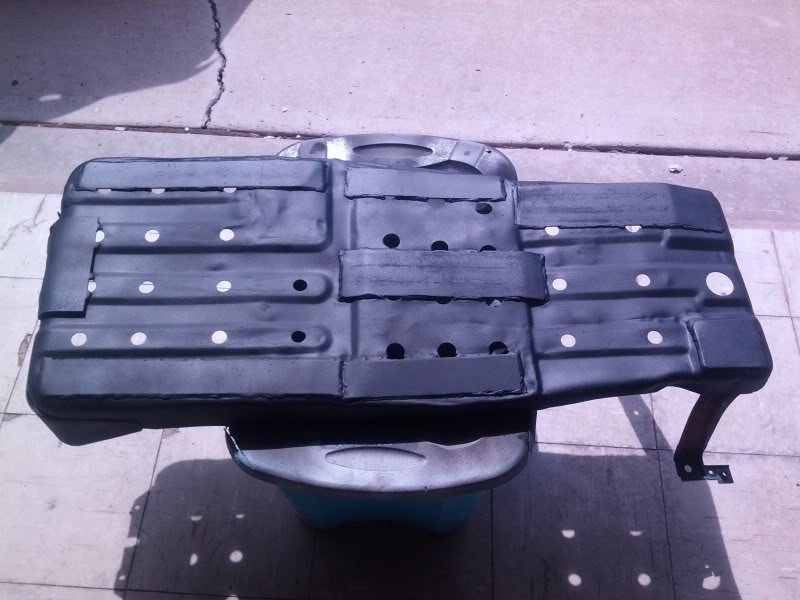

    Got to do what you got to do to make it up sometimes. Don't know that it necessarily has to do with bad lines.
    Buddy of mine's 4runner. Used some scrap he had laying around until he has some time to make his own.

    This makes a lot of sense to me. Altho, the stock materiel is not very thick. It can't be 3/16ths.

    course not..its a stock skid :p haha
    but would be a good template to use at least.
    Now that i have access to a plasma cutter..shouldn't be a big deal at all to make one.

    You could get those dents out of your buddies tank pretty easy. Block off the vents and hit it with compressed air. It will take a lot less pressure than you think to pop those out. I've tore up my stock skid pretty good too, but the 05+ has a plastic tank. Mine drags on hard hits through whoops.
