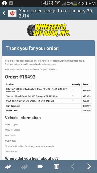

    Its been a while since I've been here. Just working and working and working overtime while possibly moving to Couer D Alene. Anyways, Uncle Sam shafted me this year on taxes and while I was looking to buy the full OME Suspension kit, I'm limited to about 600$. I've pieced together what may be a decent lift in my price range for now.
    What I'm looking for from you guys is educated, or not so educated opinions on how this looks. If you know of better pricing or deals that would be awesome.
    This is what I have so far from Wheelers in my cart.
    OLD MAN EMU 90004 NITROCHARGER SPORT FRONT STRUT SET $290.00
    OLD MAN EMU 2883 FRONT COIL SET $160.00
    2″ LIFT ADD A LEAF KIT $77.50
    ROUGH COUNTRY N2.0 REAR SHOCK SET For 2" - 3.5" L $78.00
    Comes out to 605$ w/out shipping which I can manage. Look good or like shet?

    Sounds reasonable.

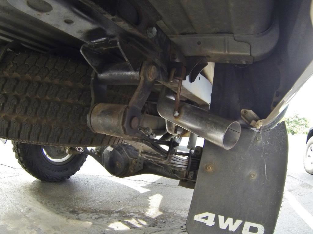

    FYI, for 2" in the rear, get an extended brake line, you will be very close to needing an extended exhaust hanger unless your pipe is cut before it passes over the leafpack, and you will need a BPV relocate bracket, but you can easily make one yourself if you want to. Get new U-bolts too.

    x2 on the ubolts, and brake line if you can spare the change.
    I ran my toytec 2" with a stock line without problems though

    I had 4.5'' with the stock line and was okay. When i flexed..it was pushing the limits haha

    Thanks for all your suggestions. I will get some new Ubolts as well. I was gonna ask you Ben about your lift and the exhaust hanger/brake lines but you already answered. I haven't heard anything bad or good about the Rough Countries, so I will test them myself.

    monte and I have ours mounted like this
