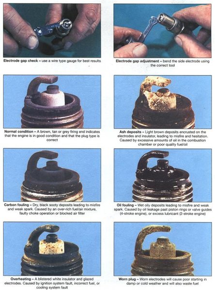

    Do you have the tools to pull a spark plug? I would be real curious to see the condition of the plugs.
    I wish I had thought of this last week. :pout:

    Installed all new inner and outer tierods again last wednesday. Getting pretty good at it now lol. Also aligned it using my wheels with the tires off. Pretty much bang on with my toe. Took it to get aligned and found out my upper bjs had some play so i got them replaced too.
    Front end is pretty much all new! Did my steering rack, lcas, lower bjs, tierods, upper bjs, cvs and in the last 6 months. Everything feels very stiff which im not use to
    Ben, check out the attached. I would pull a spark plug if i were you

    Wow..clean that thing up.
    That looks like shit.
    I say run some seafoam through the truck. Then get new plugs with the oil change.

    Is that the same plug, but showing the two sides? Or is that two plugs?

    That looks normal. The orange specks are just from the cold weather starts

    The first pic looks fine..second one..not so good..the gap looks off on one side too..

    I think it's just the angle of the pic that makes it look off...

    That's why I asked if it was two different plugs. The edges of the electrodes in the first pic are sharp, looks almost brand new. The second one, not so much.
    Ben what are you showing us?

    You gotta be clear man. :D
    That is actually a little troubling. Unless it is the lighting or the photo, those look like two different plugs.
    So the build up that is seem in the second pic is only on one side? :confused:

    I am by no means an expert on this stuff, nor about how the combustion chamber design of the 3.4L differs from non-hemi head designs, that I do know about from past experience. But I find it a little troubling that you have build up only on one side of the plug. To me it indicates you are not getting uniform fuel combustion in the cylinder head.
    If this is true, it could be the source of your knock. Which plug is that? Middle, passenger?
