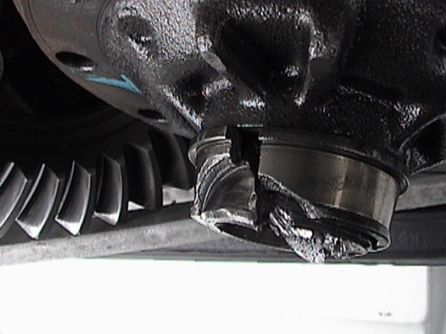

    True, lots of KOH rigs run niners. Lots of KOH rigs DNF too...
    Of course, a $10K 9" built with all the right parts is going to be tough. Tougher than a stock Dana 60. A well built car will use U-joints as the "fuse" that breaks before anything else. That's why you see spare driveshafts strapped on KOH and desert rigs... That's my plan. I just have to make the rear end stronger than a 1310 Spicer U joint. I think the most affordable way to do that, and gain better brakes, and easier maintenance of a full floating axle, is the LC 9.5". I'll let you know if I'm right in about a month. :D
    9" lockers are pretty small...
    112661d1077935847-massive-research-effor_80b4563bcbe7338f036c8c8ff0a0227676971380.jpg
