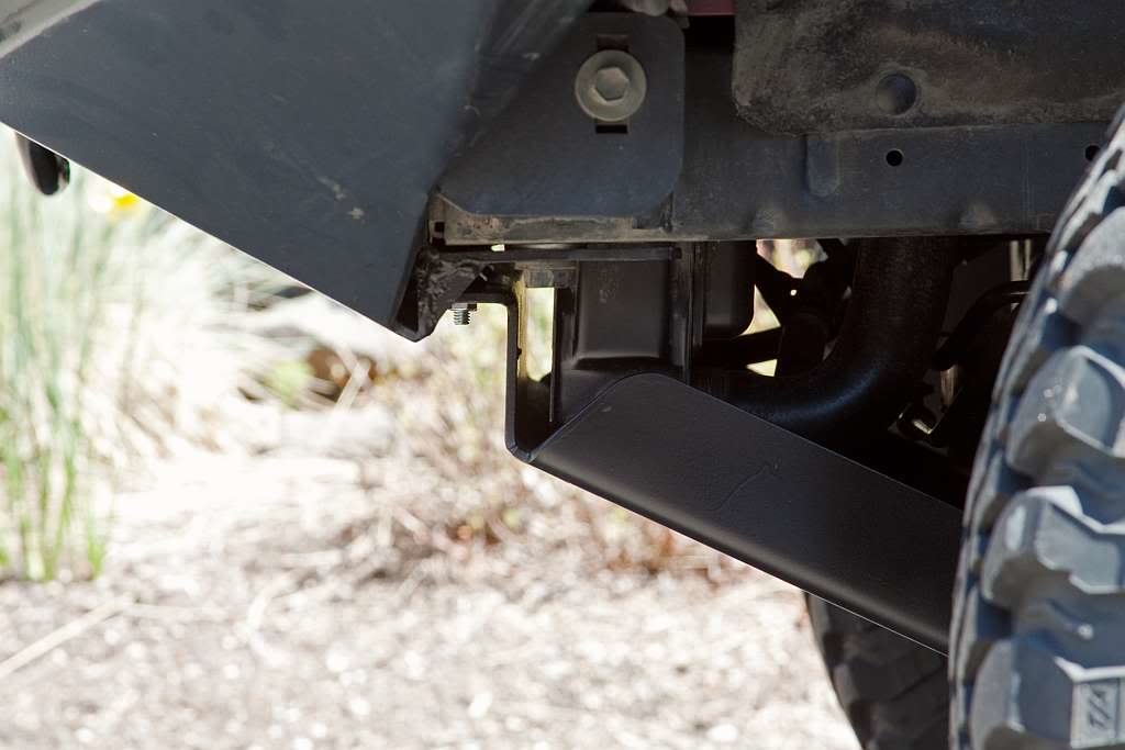

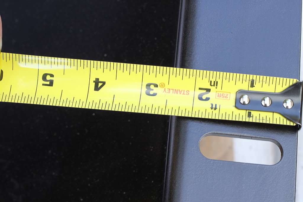

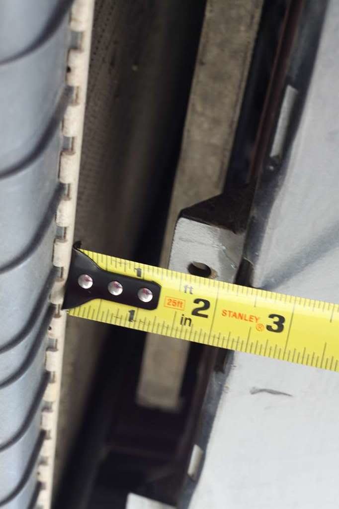

    It depends on Tim's design for his 2nd gen bumpers.
    In this pic you can see that even though the location of the skid mounts are in the same location as stock, the amount of room forward of the bolts is limited by the design of the bumper. For the stock skid this does not matter. For the Budbuilt skid it does matter.
    About 3/4" of the lip has to be removed.

    Interesting. I guess the only way to find out is to order the skid and see if it fits :/

    Its not really that big of a deal to cut it off. We used a port-a-band to cut it. I think I read somewhere that Bud will send it to you cut the right length now if you tell him when you order.
    I'm betting that tim can tell you for sure if the 2nd gen design is the same in that area.
