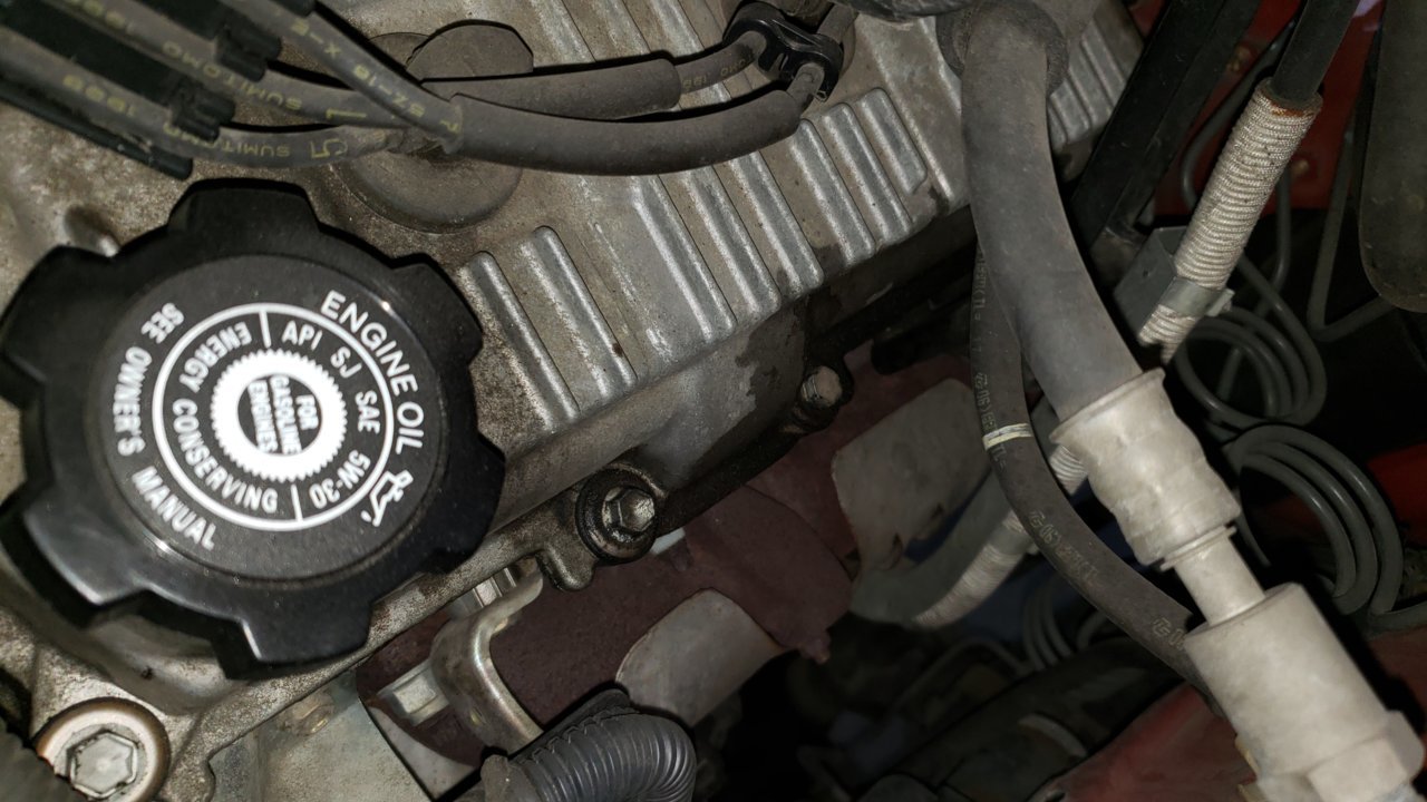

    Anyone done a valve cover gasket replacement?
    My truck is leaking oil from an unknown location. We are planning on doing the valve cover gasket & oil pan gasket. The crank shaft is covered in oil too. Photo was taken the dark with a potato, obviously.
    Anything else we should hit while we have it out of commission?

    I'd start with the valve covers. If they're leaking bad enough it will look like everything else is leaking too. If you're truck is 4x4 the oil pan is a pita because the diff needs to be pulled.

    It's a 2wd so I think it's pretty accessible.

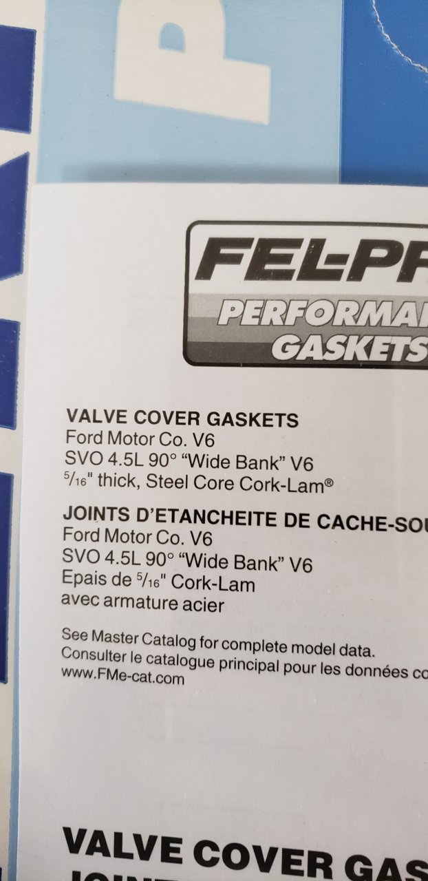

    How does one go about confirming that AutoZone saying "this will fit your vehicle!" Is actually correct? Before say, removing your valve covers and it actually NOT fitting?

    Did you see the master catalog at the website in your photo?

    NOPE. Thanks for reading for me :rolleyes:

    Yeah this is completely the wrong one.

    I could be wrong but I don't think 1st gens use cork gaskets anywhere.

    At least not 1st gen Tacomas. Maybe 1st gen Model T's.

    Hahaha. As soon as I opened it and saw it was cork I'm like, this can't be right. Thankfully my local AutoZone has the one I actually need.
