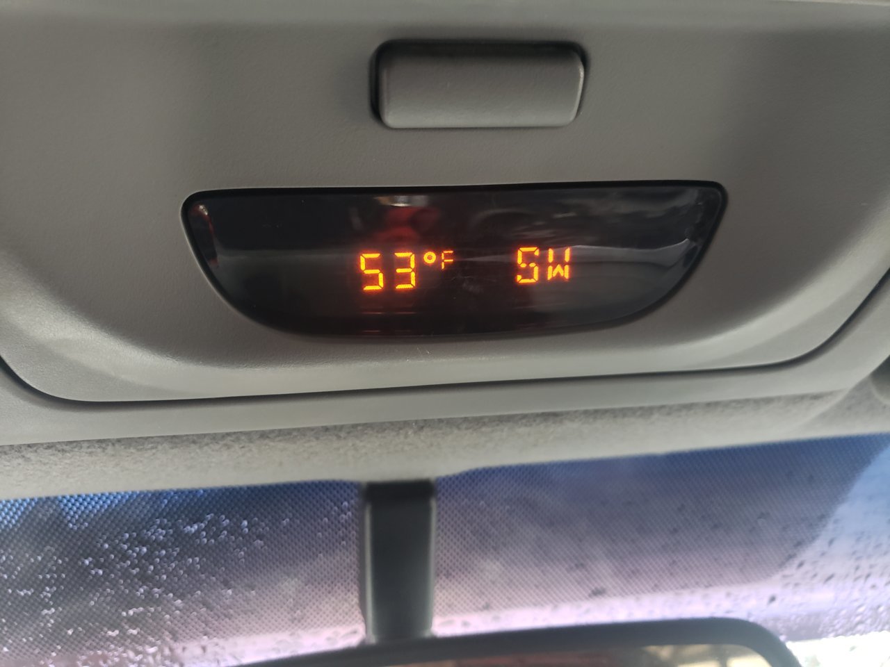

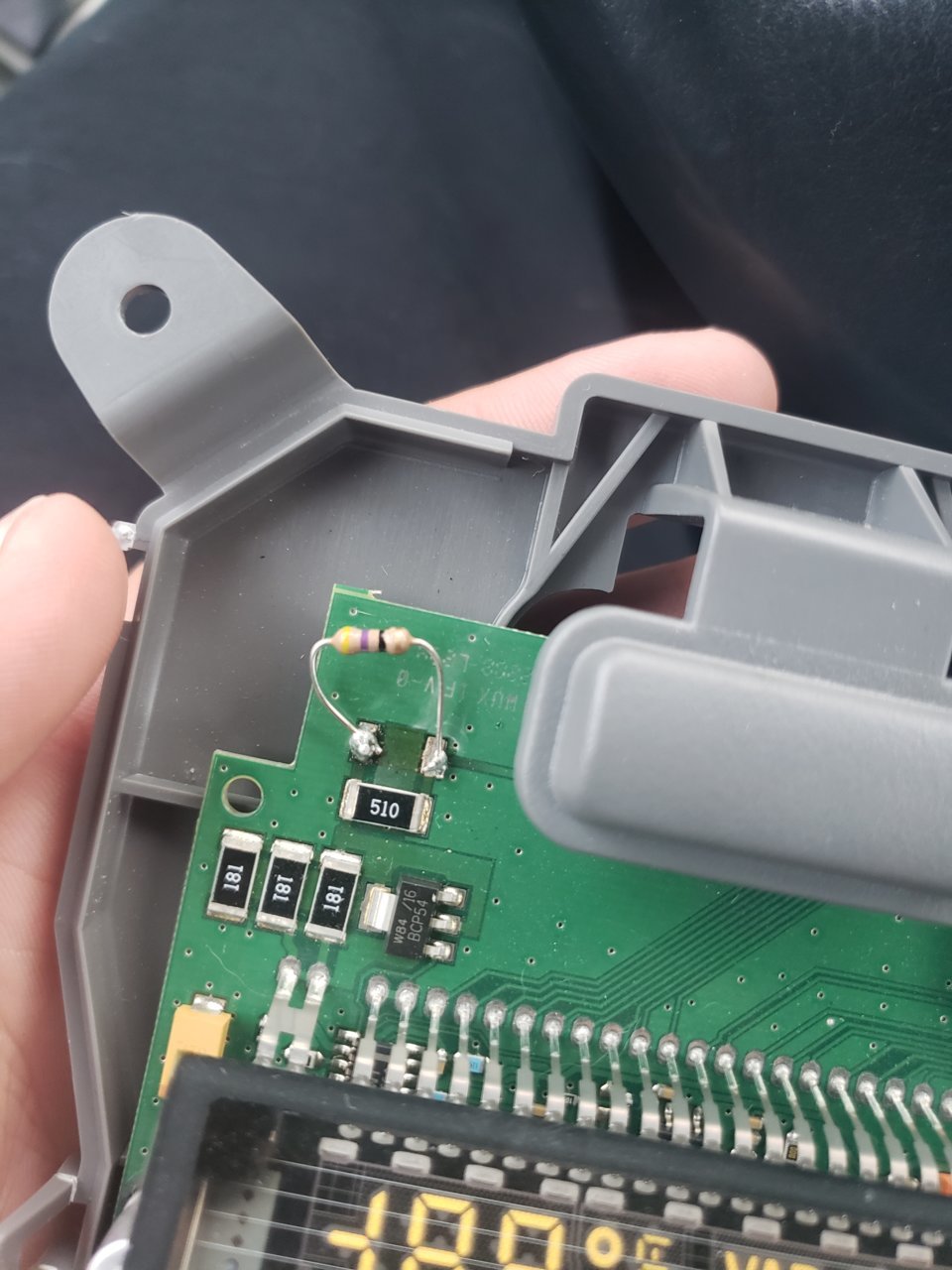

    Finally fixed my compass and temp guage after like 2 years of it not working... pretty happy to have it done haha
    If anyone's isnt working i have 99 of these 51 ohm resistors it took me not even 5 mins to solder the resistor on and put it back in the truck
