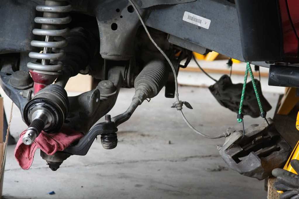

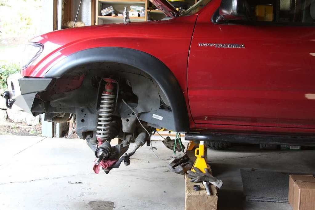

    Oh my god, that made my heart sink. So what you are saying is that I'm fucked...I can't just put in that fork or something to pry the ball joint from the spindle? I have to take apart the whole front suspension?

    did you see the glob of grease on the control arm? There cant even be much left in the BJ. Im just worried about driving 1200 miles round trip and wheeling for a week on some of the harshest terrain I can with such a crucial part failing. My one friend who's dad has every automotive tool i can think of doesn't have it, so ill have to look around. Maybe my neighbor who has a mini auto shop in his garage has some advice for me, i dont really know him that well.
    UN fortunately my truck is my only mode of transport, and I have no problem fixing it, but it looks like it is going to take 4 days and going to cost an arm and a leg once its all done. Realistically what do I have left out of that thing in the condition it is in and is there ANYTHING i can do to save this trip without me potentially crashing and seriously breaking something?

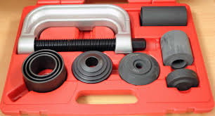

    so it looks like as long as i get that 3 arm puller i should be good right?
    which i can get from auto zone!

    Your bj is not going to fail simply because the rubber boot is torn and leaking. Just dont let the bj get dry.
    In the pic it looked like there was a tear. Fairly recent too. clean it up as much as possible. Might see if you can push some fresh grease back into it. Depending on the shape of the tear this may be possible. Use wheel bearing grease. If not, I'm sure there is still some inside, With the outside as clean as possible (maybe carefully use some alcohol to clean up around the tear) cover the tear with some 200 mph racing tape (duct tape). Use small pieces of tape. Then keep an eye on it. check it for more leakage or the tape falling off are each drive/trail.
    Its not an ideal solution but it'll get you thru until you can replace it. The key is having a little grease in there and keeping it in there as much as possible for as long as possible.
