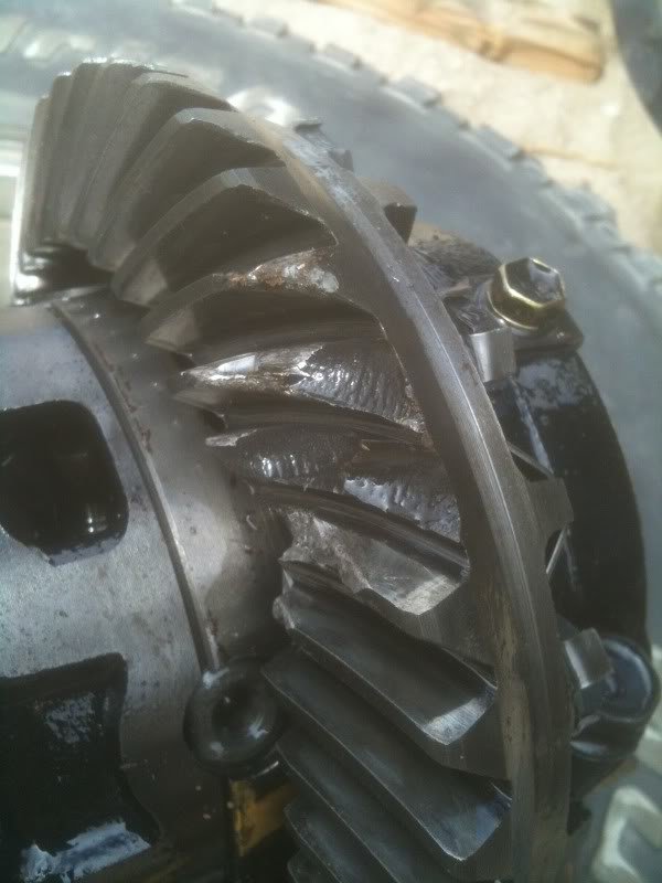

    The splines on the E-lock actually have quite a bit of slop in them too, especially if you use it all the time. I'd try putting the rear axle on jackstands and putting it in first gear. Carefully slide under it and pin point the noise. Or you could just pop the third out, it only takes 1/2 hour or so and you need to change your rear diff oil anyway. If the ring gear was blown you would know right away, and it usually takes 150,000 miles for them to get sloppy. I drove 20 miles on this ring gear like this-

    Already had it on jack stands and in gear, got it up to 25mph (on the road the noise doesn't seem to start until about 15mph) and it made no noise, granted I didn't crawl under there too far... I think the noise requires it to be under stress from the weight of the vehicle and the engine. When I shift into neutral and just coast the noise pretty much disappears.
    I know what a bad ring gear is like. haha. I couldn't go anywhere on this one, it slipped too much, had a hell of a time getting it on the trailer. The current one has about 2000 miles on it right now. So the diff fluid is pretty new too, although it may be a bit dirty from the extra shavings from the new ring and pinion.
